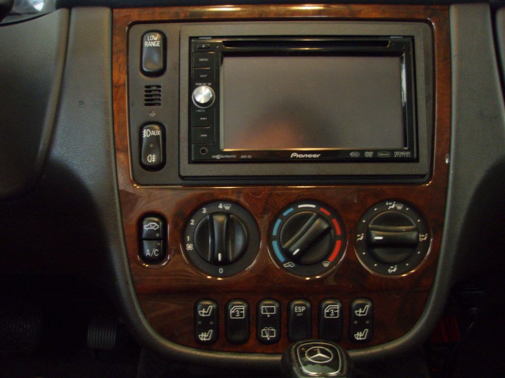

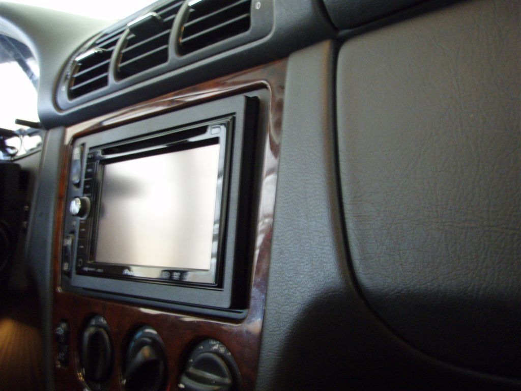

I ended up using the Pioneer double din kit. part number adt-something. It retails for $39.99 but i got it for 24.99 at a local car audio shop.
It sticks out about .5" but looks clean and secures the radio in the dash. There are no brackets for the ml320 so I had to ghetto rig a mount(aka wood and electric tape). I may try to flush it down the road but works well for now.

looks nice. For the wiring, did you have to make any modifications or you just used the ISO connector as it is?? Any information would be appreciated.

Posted Aug 18, 2007 · 21:08 UTC#8
I used the metra harness 70-1786.
http://www.installer.com/item/display_i ... it=70-1786
It wires up like a normal harness but does not connect the 4 speaker wires as it uses the rca outputs to integrate into the bose system. Very quick and simple. You will also need an antenna adapter. with the proper harness and pioneer double din dash kit, it installs like any other aftermarket radio. hope that helps.
