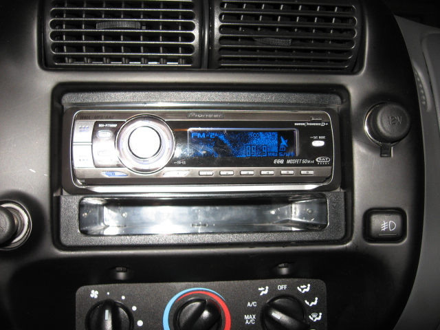

Heres the shots of the slot!
Anything here in the shots that will help explain the trimming?
Posted Jun 20, 2007 · 14:22 UTC#5
You want to cut the area in the yellow squares. Cut it a little at a time though. Better to cut to little than too much.

i installed a z1 in my bros 2000 explorer. same dash. i had to dremel the top and bottoms just like was shown in the pictures. only problem is that the top and bottom will fit since youre cutting, but the sides will have small gaps. i used the flat trim piece that comes with the d3 and cut the side pieces off and trimmed them to fit in the side gaps on an 03 superduty that i worked on. the radio opening is the same size so it should work for you. or if you want to do something easier, you can get some foam strips and spray paint them black and stick them in on the sides. it resembles black abs plastic and easy to put in as well.
