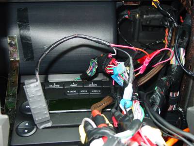

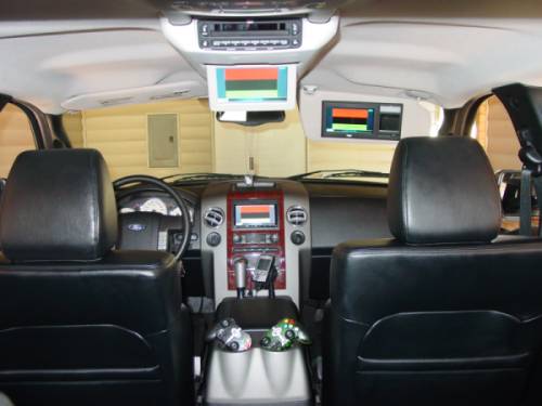

I have a 2005 F150 with a factory DVD player/monitor installed in the overhead. When you pull the factory headunit the DVD player will not work even if it is connected to the Z1. So we had to reinstall the factory HU inside the dash behind the Z1. All we need it for was to power the overhead system. Now my kids can watch their movies in the rear seats using their headsets only, but when I put in a DVD in the Z1 they can watch it also but the sound comes out of the speakers. During playback if they decide they do not want to watch what is playing on the Z1 they can put in a movie on their DVD player and that signal overrides the Z1s signal. Again when they hear through their wireless headphones and my can listen to music or she can watch the movie on the Z1 or her visor monitor. I have attached a picture of setup and a picture of the factory HU in the dash. I hope this helps you out.

The factory is connected the Z1, but through the rca outputs that are right in front of the DVD player. You know in the F150 when you pull the screen down there is three rca plugs for connecting a game system or a camera? We tapped into the back of them and used a Y connector. That is how you can see the same picture on all three screens.
