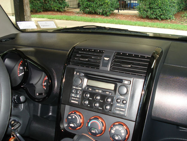

Posted Jul 15, 2007 · 16:02 UTC#8
Do you have tweeters in the A-Pillars? The amp (if you have one) is behind the passenger's side kick panel. Do you have an LX or EX?
Here's some pics of my D3 install:
