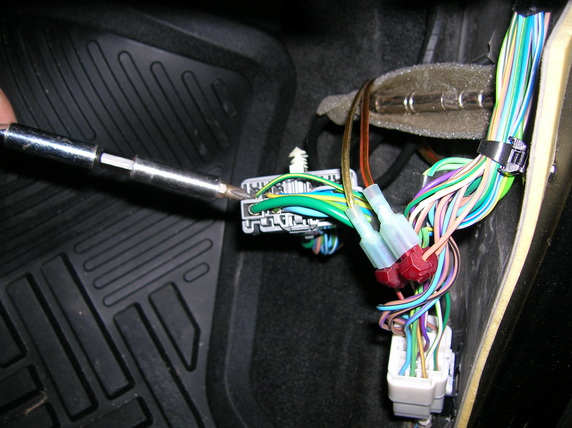

Posted Jul 29, 2007 · 01:18 UTC#5
Is this the vss wire on the grey plug on passenger kick panel??? It's pin #13

Posted Jul 29, 2007 · 17:49 UTC#7
That looks like a pic of the pass kick panel. The PCM is on the pass firewall under the hood. What is your multimeter readings when you test that wire?
