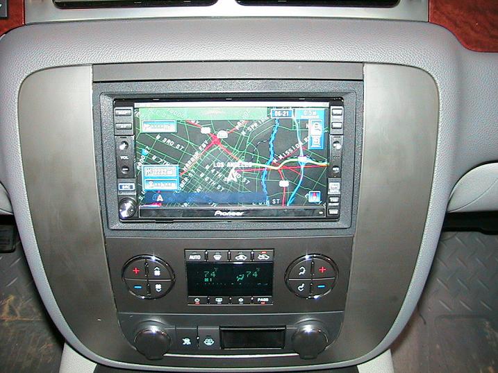

I really appreciate your input on this. I want my AVIC-Z2 to be a flush install. Just to make sure I am on the same page. When you refer to the sub-dash I assume you are referring to the molded plastic that is behind the factory stereo? Once it is removed (cut out) it exposes a metal bracket connected to a tubular shaped metal cross member? Does it look like the following two pictures after you cut out the sub-dash? And how much more room do you estimate you gain when you gut out the sub-dash?
http://www.lazyassgeek.com/photos/album ... ll_001.JPG
http://www.lazyassgeek.com/photos/album ... ll_002.JPG
Thanks,
Chad
Posted Aug 03, 2007 · 00:05 UTC#9
That looks right. Now you have room to tuck all the harnesses under the metal support. If you are installing XM, the tuner will fit on top of the on-star module(the silver box in the lower of the opening) and under the plastic.

Here's mine in an 07 Avalanche. I have full pics of install if you want those as well. If you have any questions about the install let me know. It was actually easy.
