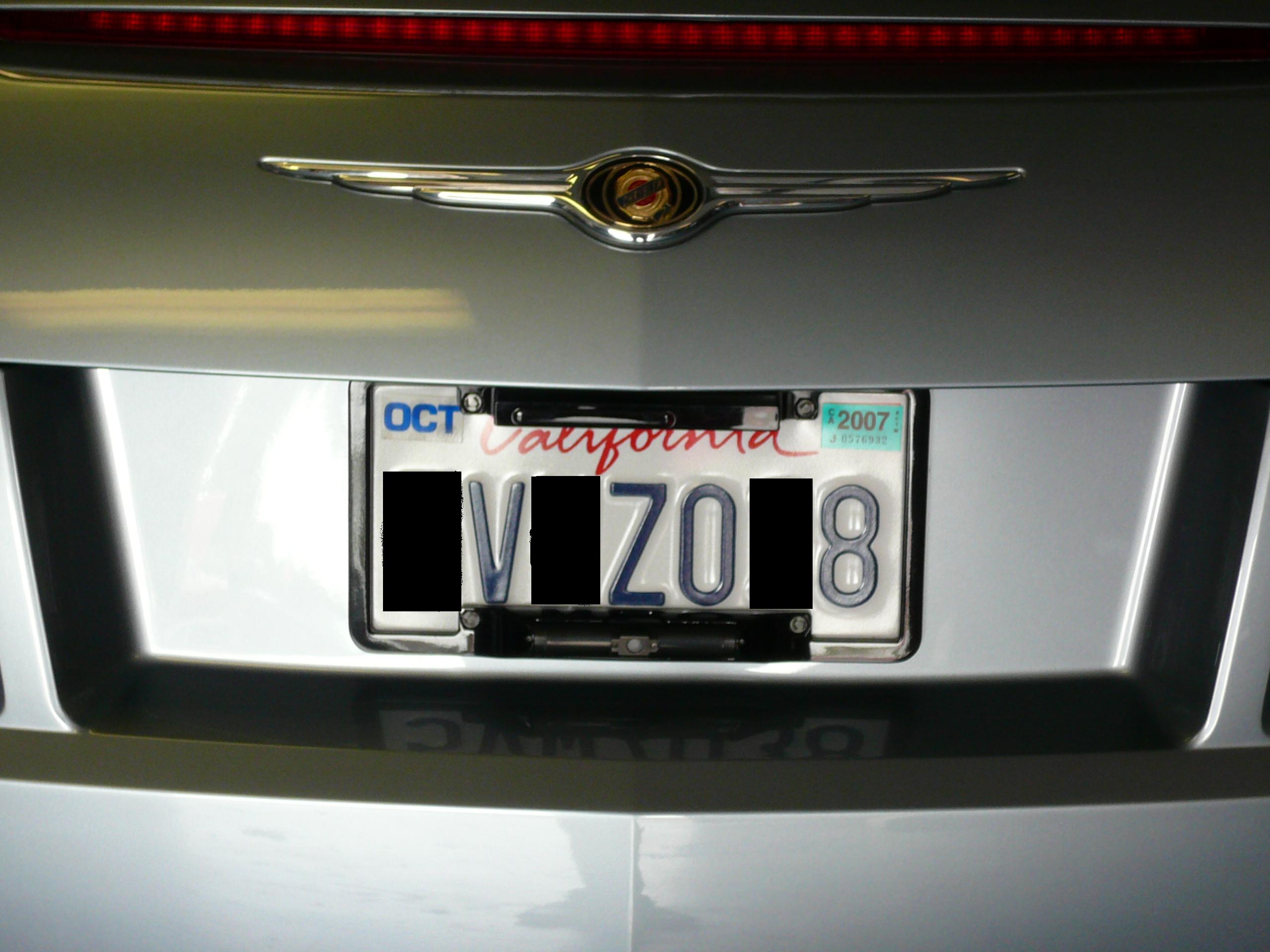

http://www.audiooutfitter.com/store/646261/vtl300.html
This is the one I have. Love it! Comes in chrome, too. Mounts with bolts for theft security. Good night resolution and durability. I had my installer flip the camera upsidedown so it could be mounted on the bottom. See pic...
HTH
