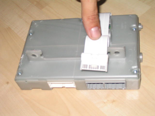

I'm not sure if i am looking at the right part...attached is a picture of what I think I should be looking at. If this is right then which is pin 26? there seems to be a grey 20 pin connector a grey 16 pin connector and a white connector with 13 pins on top and 11 on the bottom. Please be more descriptive or let me know if I'm even looking in the right place?
Posted Aug 27, 2007 · 04:31 UTC#4
That's the piece you're looking for. Should be in one of the gray plugs if I remember correctly.
