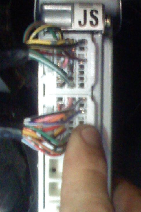

Was about to do my Camry on Monday night, i have read alot of posts from this website over the past month or so and wanted to make sure I got this right. I even went to the12volt to find some more wiring info as to not ask newbie type questions. Then today i check posts and see one about the same location as my Camry after doing all that research. I took pictures of where i think this VSS wire is on the ECM behind the glove box and i just was hoping for conformation before I go back in and hook it up. Thanks for the help/replies in advanced. Drew

I tried blue/white, purple/white, violet/white red/white wires at the ECM for both top and second from the top connectors without any success. I thought I might be doing something wrong, so I went to a stereo shop that installs Pioneer AVIC's and they replicate what I did without any success. I am back to square one. Any idea what the next step should be, as I am confused.
