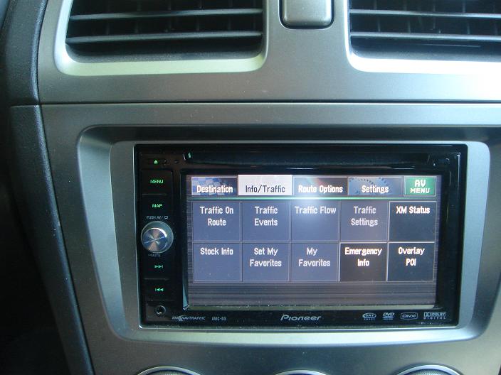

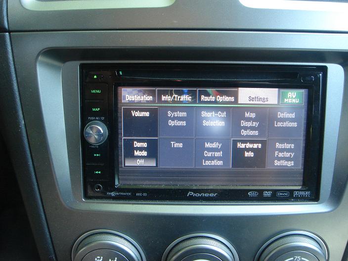

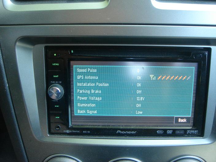

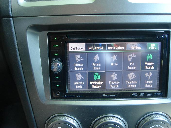

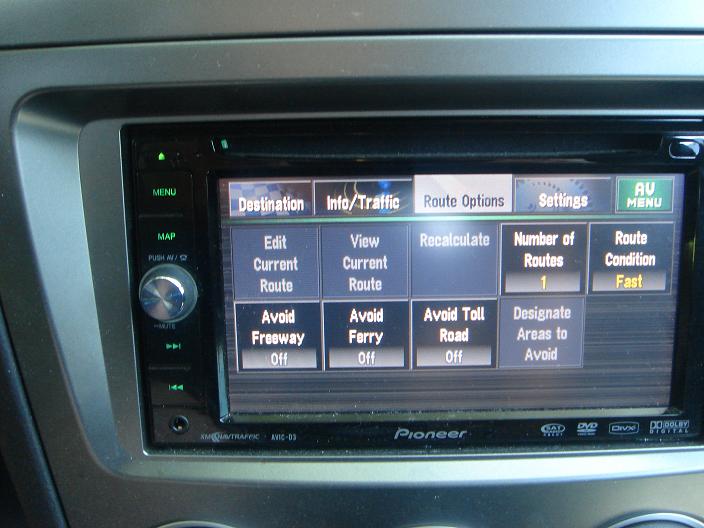

I'm not getting full functionality out of my NAV. Specifically, I can't punch in any address to plot routes.
Wires NOT hooked up are:
- VSS
- Reverse sensor
- Parking brake
PLEASE tell me it is something painfully obvious that I've missed. All other connections have been soldered/taped and the GPS works fine otherwise.
Thanks - Sean
Here are some screen shots:

do the bypass or hook up the brake wire and stop and apply it.
Posted Sep 04, 2007 · 19:40 UTC#3
Thanks. Do you think it has anything to do with my VSS not being hooked up?
Posted Sep 04, 2007 · 19:42 UTC#4
nope without the parking brake grounded it will never let you do all the features. once its grounded u can use but not while moving.
do the mute wire bypass and you can do it all whenever
