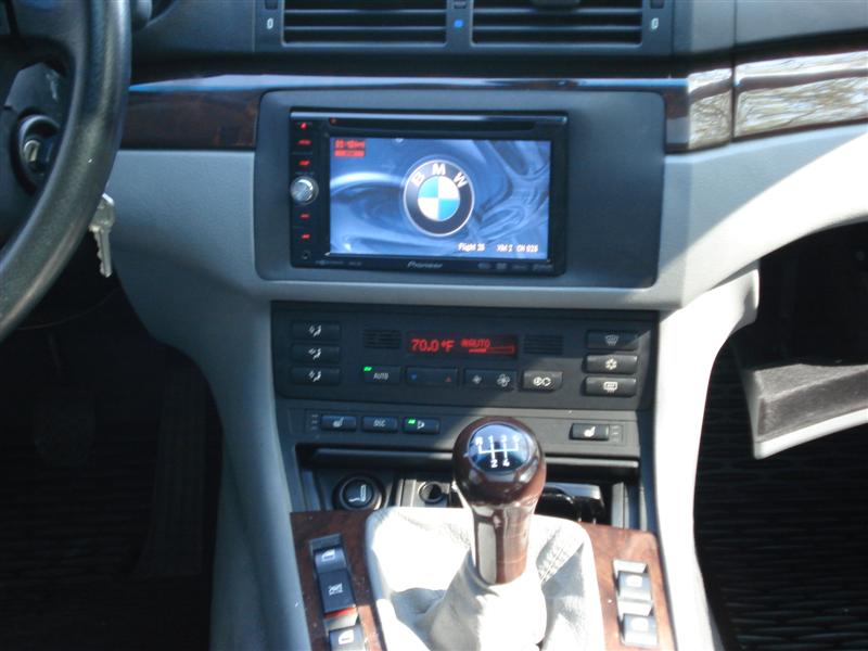

I have the d3 installed on my e46. I matched the colors to the amber and it looks good. I also changed the splash screen and background to a BMW logo. As far as using a USB drive to load mp3's, I don't know. That's something you can do a search for on the forum. It's unfortunate that you hate apple cuz I bought an Ipod specifically for my car and it works great. I also added the bluetooth phone option instead of using the BMW bluetooth. I've used a Razr, the Motorola MING, and now I am using the Blackberry Pearl and all have worked great. The Pearl has worked the best so far as it transferred my entire phone book, shows the battery meter and signal strength. Not sure how far you have researched doing a double din install, but it does take some modifying of the air ducts behind the dash. And you have to relocate the A/C controls to the sunglass storage area. Any other questions you have feel free to ask![/img]
