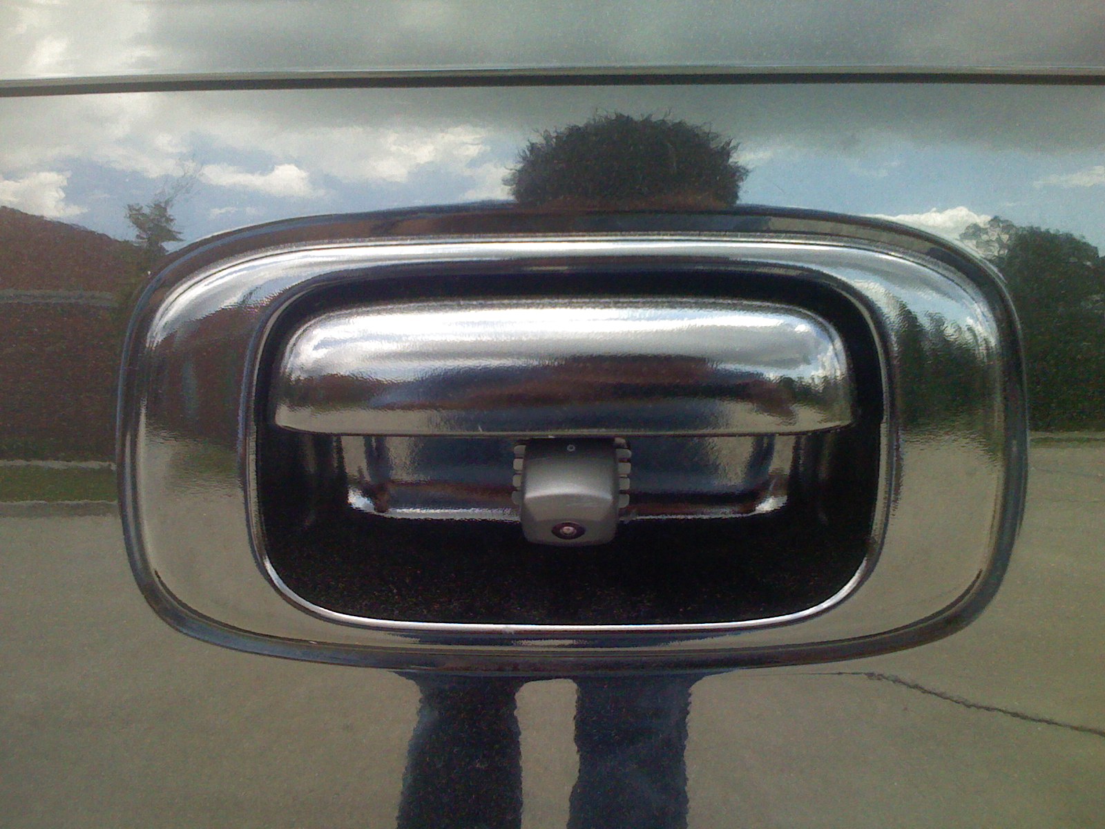

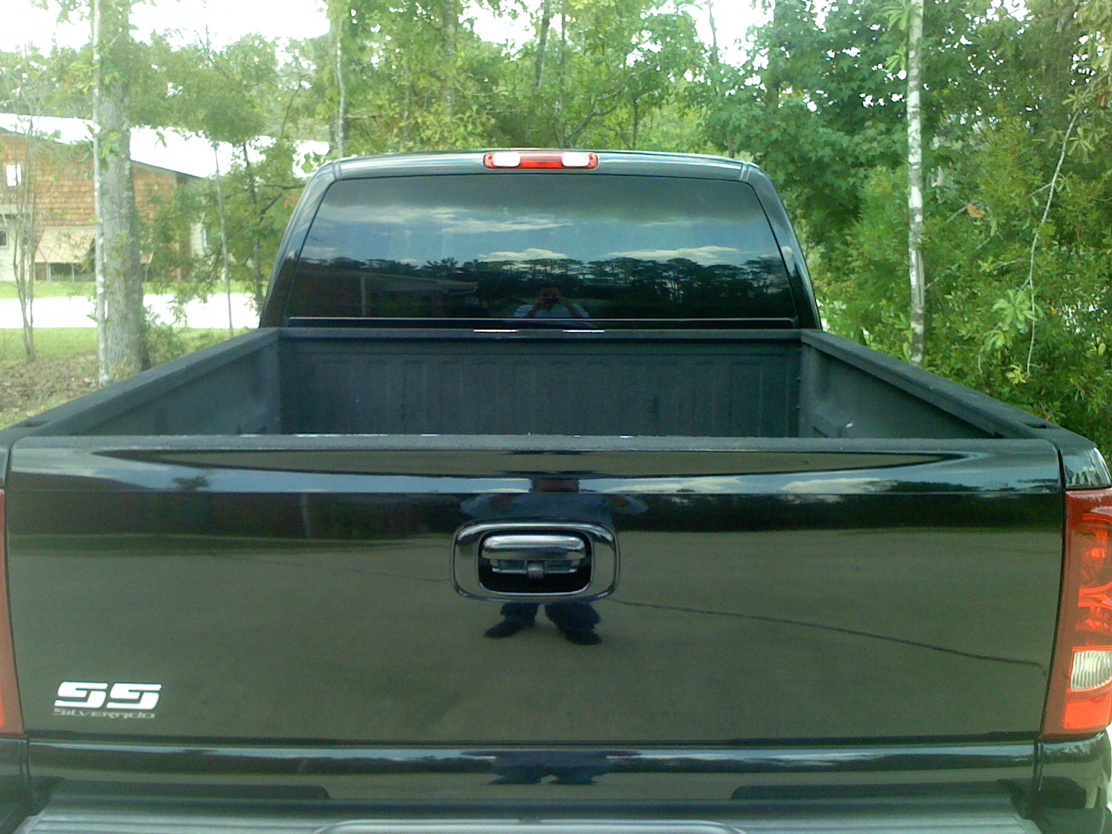

I just got done installing a Z2 in my 03' Silverado SS....I baught my Z2 in a package deal with the Pioneer camera.....so I figured I'd check it out and just stuck it under the tailgate handle and fished the wire through the tailgate's handle and out the bottom....I had all intentions of grabbing the VTL300....but I'm kinda happy with the results of the Pioneer setup thus far...and although it's semi ghetto..I'm not rushing to go grab the VTL300 just yet.....
crappy pics.....but you get the idea...
I wasn't thinking to take a pic with the hitch in place....but I can do that tomorrow if you'd like...

Couple questions:
How well is it mounted? Is it permanent for you, or do you have plans to relocate the camera? I ask because you said it was "semi ghetto", are you speaking cosmetic or structural. I looked at the bezel on my truck and is to mostly curved, is it flat enough to provide a solid base? I noticed your truck in the SS with nice painted bezels, wonder if they are much different, other than the paint. Does the camera get in the way of the handle when you slide you hand in to open the tailgate?
From what I can make out of the picutres, I like what you have done.
Thanks for the help.
Navyute

I mentioned "semi-ghetto" cause it's just stuck there with the double-sided tape that came with the camera....as well as I had originally planned to cut the bezel so that I could recess the cam a bit more....but after thinking about the hassle....and other camera options, I decided to just stick it there with the tape to test it out...the tape is super "industrial strength" tape....and so far no signs of it moving....as well as the camera doesn't shake/vibrate while driving either...so I think I'm going to keep it there...
the camera's mounting surface is actually cut with little fingers...and the material is flexible...so you can bend it to the slight round shape of the bezel....just to maybe explain a little better...it's made to wrap around things...it's probably made of thin stainless or some kind of alloy...
it does kinda get in the way when opening the tailgate...I just spread my middle finger and ring finger apart(like star-trek...lol) but it's not really a biggy for me
you can only mount it so far up before the lever will hit the camera when opening the tailgate...I may eventually cut the very back piece of the handle so that I can mount it further into the bezel...and make the cam a little less visible....as of now, it's barely noticeable as mine is painted black, and semi cloaks the cam...

here's a couple that I just went and snapped with my cell...

Your the Man! Thank you very much for taking the time to take pictures and providing all that information. Great pics by the way, I can see the little fingers you were talking about.
