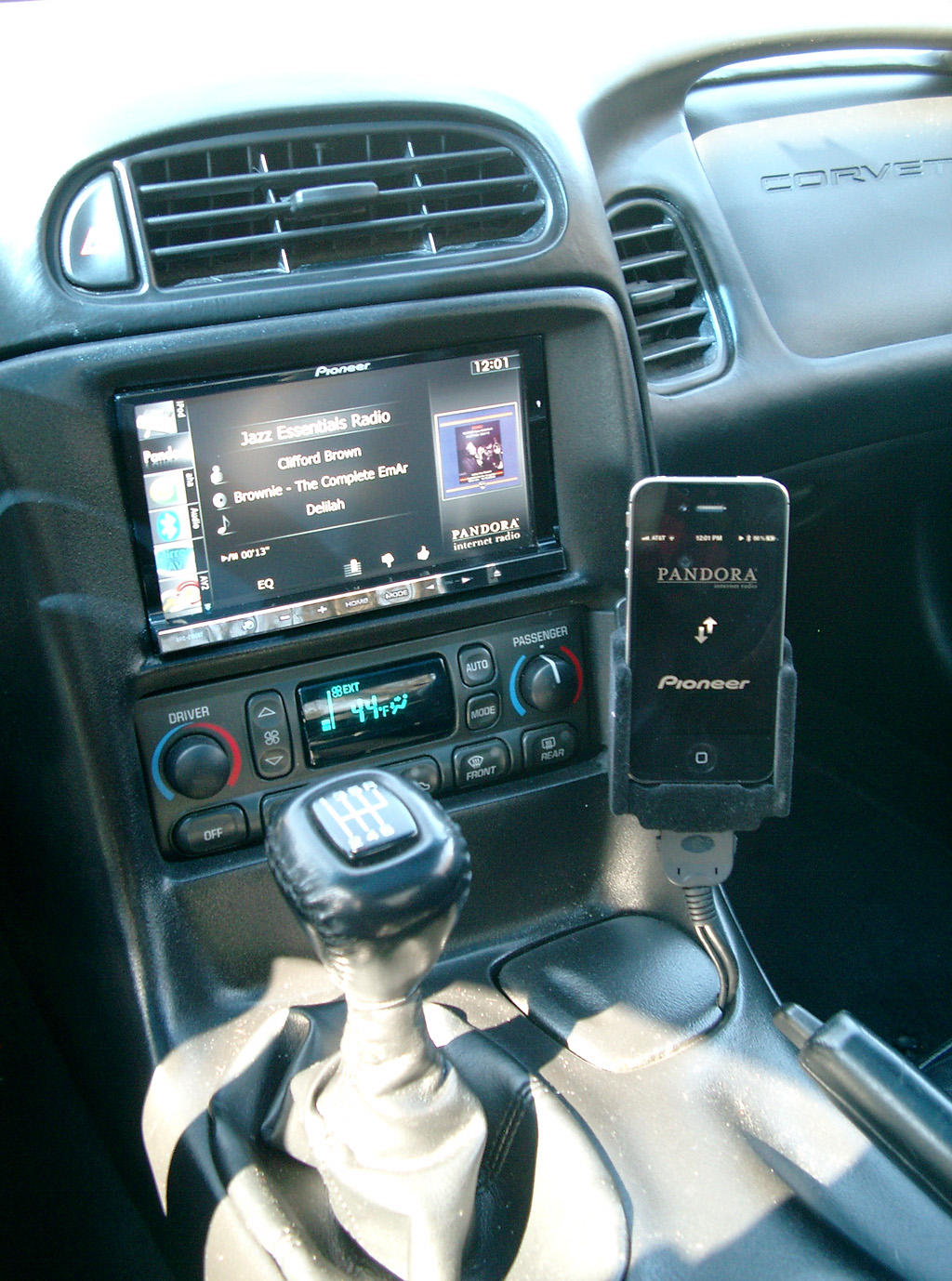

Here's some pics of the installs - the CTS-V involved downgrading to a base CD radio, hacking to make a DD size hole in it (had to move the motherboard up, discard the CD, etc.) and custom wiring.
The Corvette involved getting a custom bezel made (delete ashtray, move down HVAC controls, create a DD opening).
You can see why I really want to update, and not replace. So far I have only done the base update to 3.002 and BT is at 3.22.  BT works, and with a just a lightning cable (not 30 pin adaptor)  the iPhone 5 almost works - good Pandora/Aha touch screen response, but no audio (don't care much about video).
