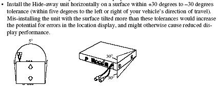

No, it just needs to be flat with the arrows facing the correct way

I am going my memory, but I think it has to be level with in 5-10 degrees.
Anyone have a manual handy?
Posted Sep 11, 2007 · 20:34 UTC#6
I was off by a bit. No more than 30 degrees.

Ok, now I have the right part.
If it is sitting at an angle > 30 degrees then bring it back and insist they relocate it.

I would definitely ask them to move it. Gyros are very sensitive...Surprised it even has 30 degrees of play
