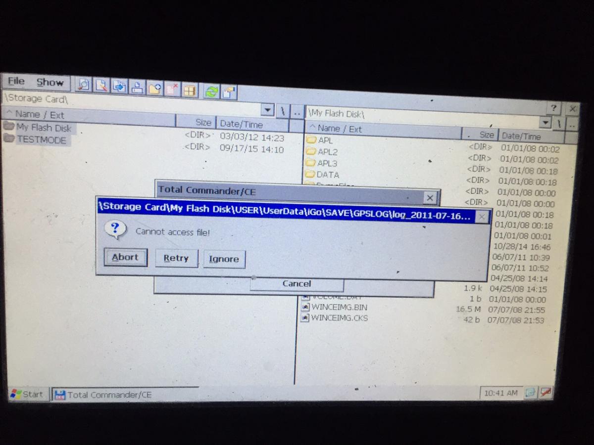

I have done these steps, replace files from your disk and update wince,  but the unit is in same way as before, i cant access setting or maps and the startup message doesnt dissapear...
++ Well, during the replacement process some files couldnt be accesed. so i ignored them (look the photo)
      Also i have copied testmode folder... which files were not recognized.
what should i do now?
Edited Sep 17, 2015 by hendrix84

no let testmode in your storage card if you copy them only click and stay on the folder testmode of your flash disk when the folder be in another color select delete
for the files only ignore them , are you delete your flash disk before copy my flash disk ?

Ok, i will delete testmode
No, i just overwrited the files of your flash disk to my flash disk..
Posted Sep 18, 2015 · 18:18 UTC#11
Hi delete all your files and after copy my flash disk
