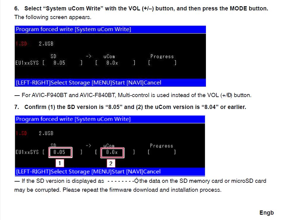

Duke_BE -> When you get to step 7 and see the screen that you posted an image of - make sure that the media storage selected is "SD". Notice in your image it says "USB". You use the track left/right arrows to change this. That might explain why your new files were not found.
Also - just a warning. This procedure unfortunately requires you to use Testmode to install the new files. Testmode can be very dangerous. Other people have accidently bricked their unit by choosing the wrong menu item. For example in step 6, make sure you are on menu item 1 "System uCom Write", and not "System uCom All Write".

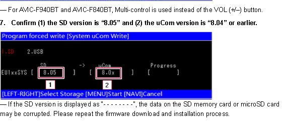

So, stupid question maybe, when it's red highlighted, it's the right option, correct ?
Looking to a capture of the manual, which I attached, it is on SD, right ?
Also, thank you for your warning, but also for this case I used the default setting: System uCom Write.

I'm not sure - I have -+ buttons on the Z110. I think that means the volume knob.
Yes, it appears that the red in the image is the current selection. I don't think the actual headunit display uses colors (at least on mine). It uses inverse highlighting instead.
