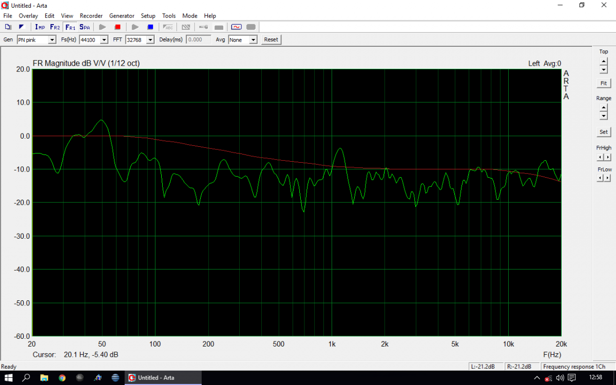

I used a elektret-microphone capsule, with a simple 3,7V phantom-power from a LI-Ion batttery, a resistor and a capacitor and it worked.
Frequency Response (Pink Noise) after Auto-EQ, measured with the same capsule:

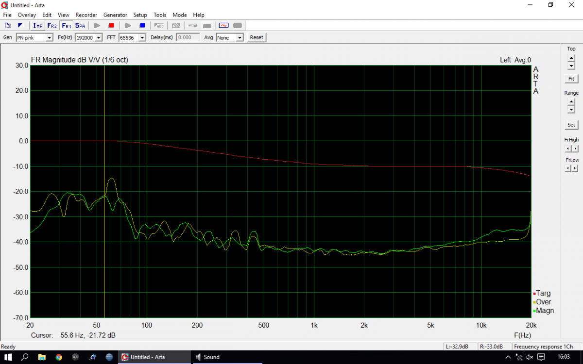

But, the auto-EQ produced a lot of background noise (approx 5db) beginning at 10kHz on my unit, so i switched it off and use the custom-EQ only.
This is "silence", yellow with auto-EQ off and green with auto-EQ on:
