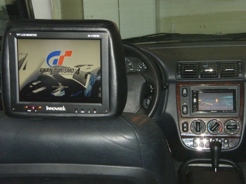

Posted Sep 22, 2007 · 16:10 UTC#3
pics of dual zone in action...
Fast and Furious Tokyo Drift in the D3 dvd slot playing up front and Gran Turismo 4 playing from the ps2 in the rear. I also just found out that I have speakers built into the headrest.
