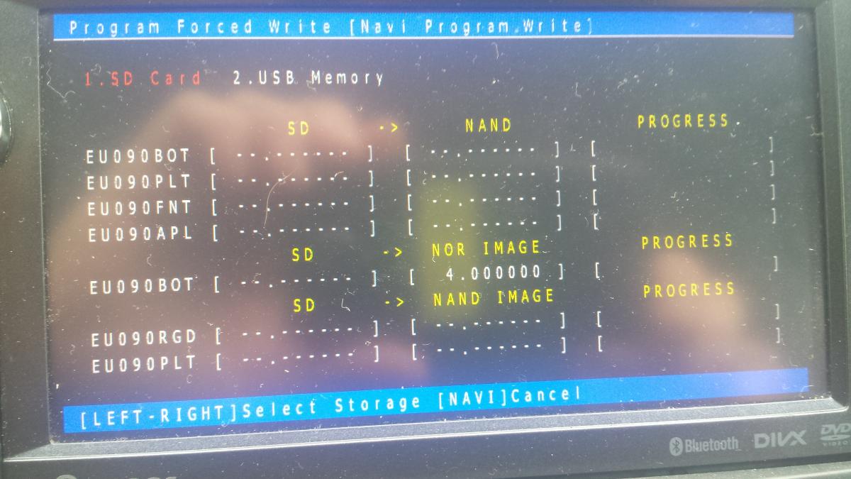

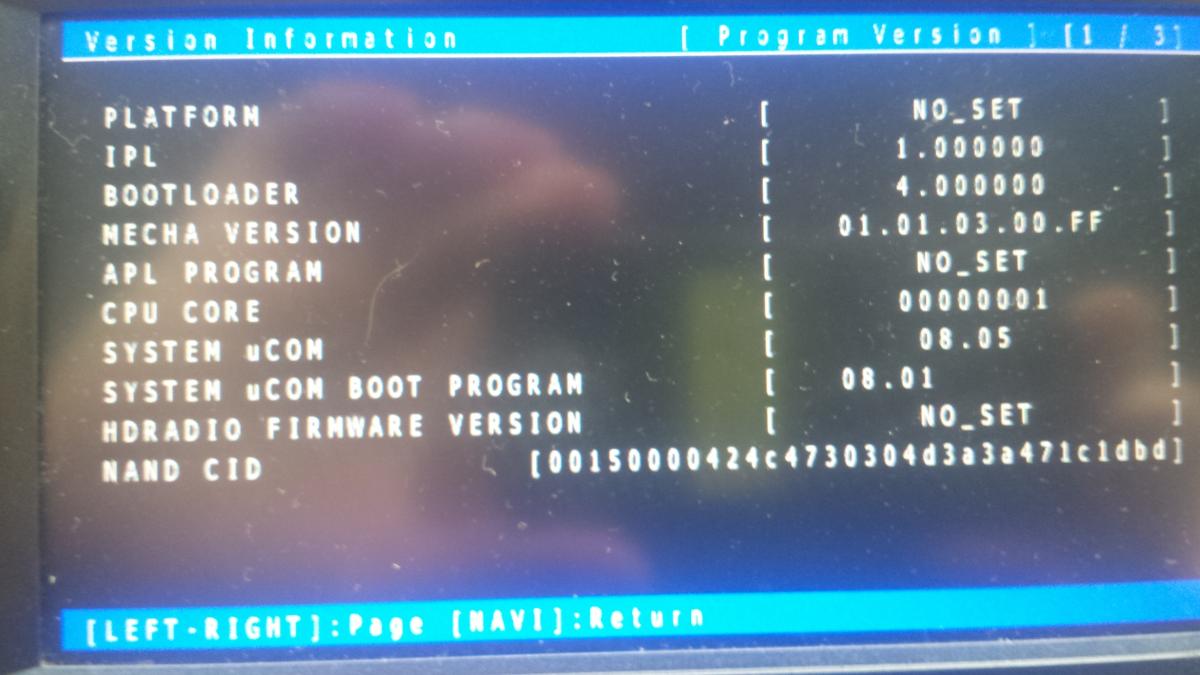

Ichn trying day with the Super Test Mode, firmware and also with my backup files to get ahead. As I have now 5,100 loaded the firmware in my unit came on the screen: "Program forced write system uC com Write"
by pressing the Mode button came under the same program on the screen:
SD 8.05.0000 un d UCOM 8.05, after pressing the Mod button came under Progress: "Start" and turn to press the Mod button ran the counting under Progress from 0 to 3644, if somewhat was installed, I can not say.
Unfortunately I do not get ahead and hope to help here in the forum.
To better understand the photo attachments.
Uli
