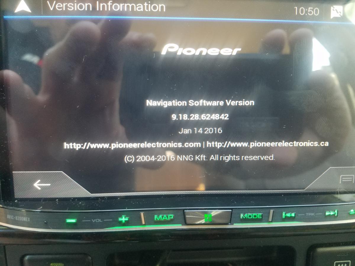

    a. What is unit's and navigation's current firmware and software versions, they are not listed on Pioneers web site, the web site you provided below (pioneer.naviextras.com), and the technical support man I spoke to claimed not to have access to them.

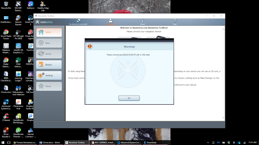

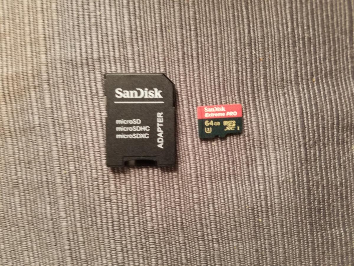

    b. When I followed the instructions listed on the website you provided me below to update the navigation software (and check if it's current) I received an error message, please see attached picture. I used an SD card and followed the precise instructions, which are sort of backwards in the sense that you first have to put the SD card into the units SD card slot and transfer the current navigation software version to the SD card, then come back inside and put the SD card into your computer to even be able to log-into NaviextrasToolbox (on the computer), please see screenshot below. But, the Naviextras Toolbox seems to want me to take my laptop outside to the car and connect it to the unit via a USB cord (different than the instructions on their own site for the unit, please see screenshot below). So bottom line is I need to know the correct manner to check and update the navigation software.

2a. This should list on pioneer website under download.

The Naviextras Toolbox application isn't only for head units.  It's also used for handheld units.  Handheld units get connected directly to the PC.  Headunits use storage media to transfer files.  You must insert blank SD into head unit first, and run SyncTool, so head unit can write your license, map files, versions, etc. to the SD card so Toolbox can validate your head unit and determine what mapping software is on it.
