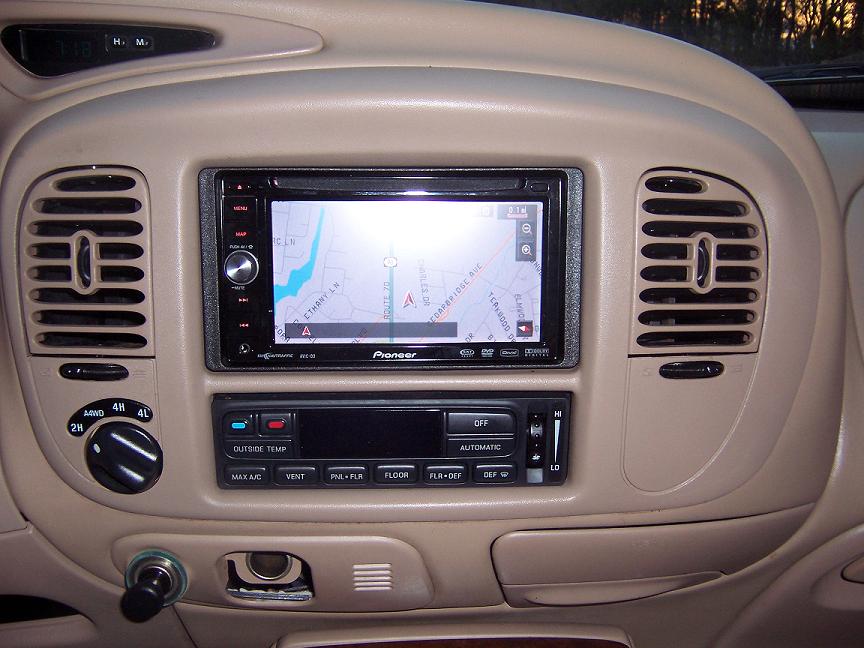

Is that a picture of a Lincoln Navigator and did you do the install? Looks nice.
When you say severe cutting do you mean behind the trim or cutting of the trim?
Thanks. Yeah it's a 98 navigator, but the dash is setup the same way as the expedition. I did do the install and just to give you an idea. I'd charge $350 for the work. $400 if I had to integrate the factory overhead. Average time for the modification is about 2.5 hours. Not saying that's fast or slow, just how long it takes me.
Behind the trim only. The trim is 100% in tact.

Posted Nov 27, 2007 · 04:54 UTC#6
I installed my Z in an hour. I only had to cut the plastic trim seperating the radio and climate control. 2 minutes with the Dremmel. Mine looks the same as his pic.
