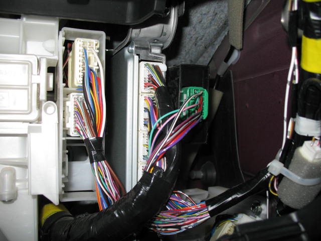

Misfit thanks for the help but i cant find what your talking about, im posting a picture of whats under my glovebox. if you could point out to me which wire it would be i would appriciate it!
thanks
Posted Oct 03, 2007 · 11:01 UTC#4
should be the big module with the 4 or 5 plugs on it. if you cant find it try the fuse box location
