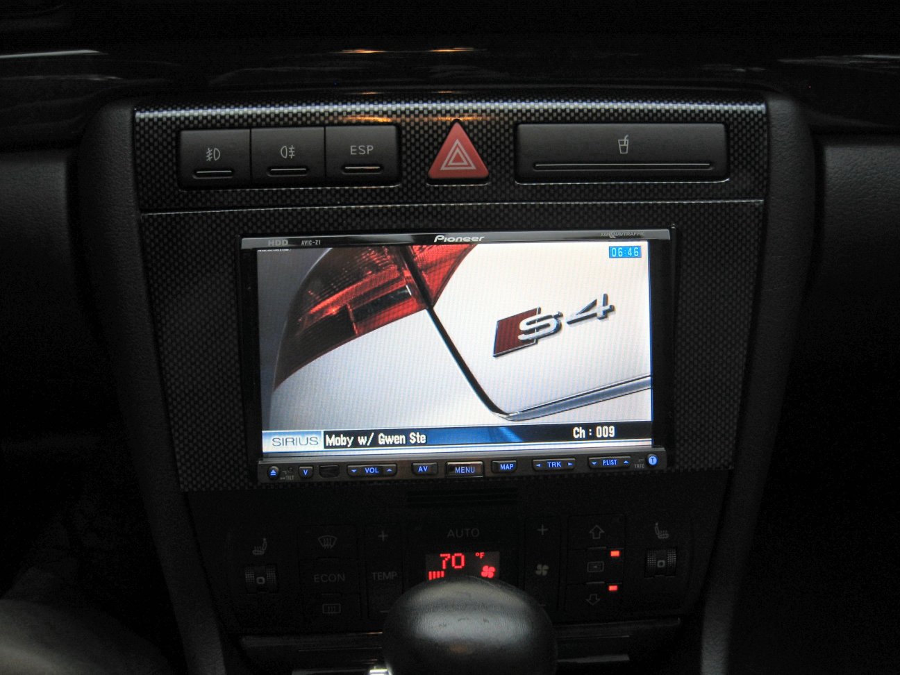

:D This is a MAJOR Pain in the Ass to get installed.. No company on this earth makes a mounting kit for the S4.... I had to fabricate one myself out of MDF, then I covered it with Carbon Fiber. Tell me what you think...
The Z1 has XM, Sirius, Bluetooth, Backup Camera, Ipod, etc.....

I think it looks AWESOME! Very stock. If you didn't tell me you made that yourself, I would have thought it came like that. Very nice!

WOW!!! Very very nice!!!

Good Job! It would be neat to see it torn up before you put it back together...it gives us a better sense of what you were up against.
Posted Jul 13, 2006 · 00:12 UTC#5
I took out the Stock SYmphonhy, then detached the front face from the rest of the radio. I was then able to get a decent trace of the shape onto a piece of MDF board. I then measured the exact dimenstions of the radio and got it as close as I could to the shape of the symphony. I used a jig saw to cut the MDF and I cut it 1 1/8 bigger all around so I could sand it to form the exact shape I wanted. Once I got it right I just mounted the head unit into the MDF with some l brackets on the back side. It is such a tight fit in the radio housing it can't move anyway. As far as the Fit, the Avic-z1 is tight but does fit the B5.
Once it was close I tested fitted it in the radio location. The hardest part was cutting out the center where the radio sits, thats a pain to get right. I went through about 3 of them before I was satisfied with the result. I had planned to just match the flat black paint, it looked 7 out of 10.... I wanted more... I read somewhere about the vynal Carbon Fiber, so I went on ebay and bought a 4 foot piece, it is self adhesive and went on the MDF like a charm. It looked 9 out of 10, but the wod trim just above it looked off, so I pulled the piece and matched it with the same carbon fiber hence the photo... It is very clean now, I wold love to have the brushed aluminum trim or piano black to match it but it is too much... I may pull the shifter cover and use the CF on that too.

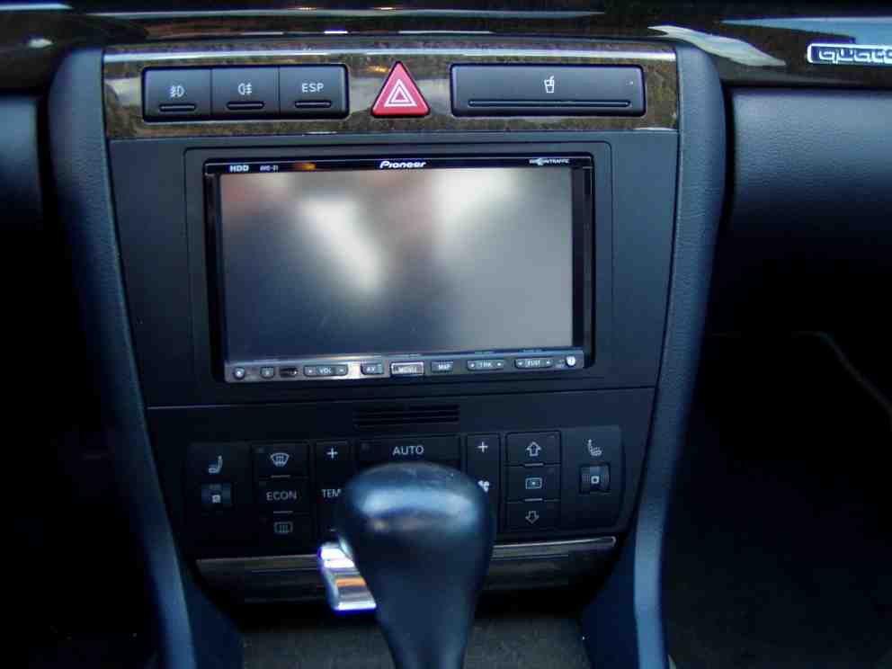

Hey man, that looks great. I've got the Z1 wedged into my '00 S4. I don't have any pictures yet, because I'm really not happy with the finish, yet. I've got the stock wood trim, which I love, but I'm having a really hard time matching the semi-flat black panel. I think I'll just end up fiberglasing it, and painting it. Looks like you've got the same problem I do; the stock 4X4 stance.....I'm ordering Stasis tracksports in Sept. Car looks great, man.

Looks totaly stock now. Much cleaner...
Posted Oct 26, 2006 · 19:37 UTC#8
Go back to the Carbon Fiber!
Posted Oct 26, 2006 · 20:15 UTC#9
CF looks good in this picutre, but in the real world the Metra looks much better. The CF looked like covering not the real thing. THis is a perfect factory match.
Posted Oct 26, 2006 · 20:16 UTC#10
I May try to cover this new kit to see how it would look.. But if you saw it in person it looks better than before.
Posted Oct 26, 2006 · 23:11 UTC#11
Wow, looks really factory. Nice job on the install.

It does look really good, James. In the pix, the CF looked great, but knowing what the rest of the car looks like, it would look out of place, only being in the center radio stack. My kit is ordered, & will be in next week- Can't wait to get the crappy looking piece that's in there now, out. Thanks for the tip, bro.
