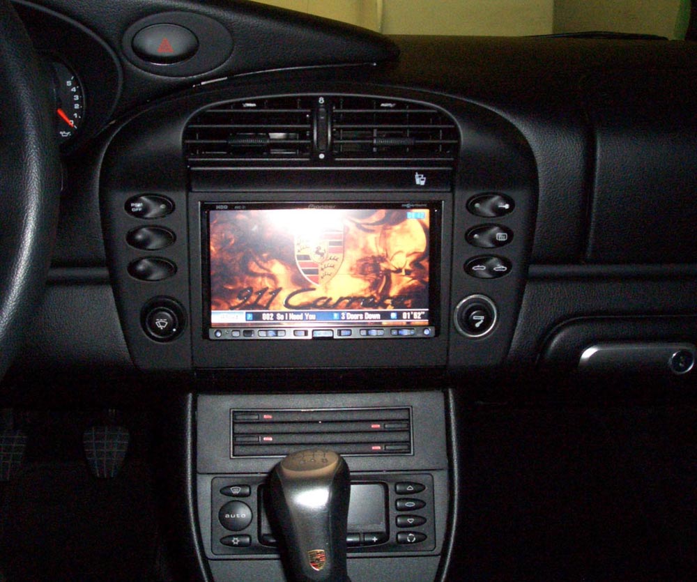

Thought I would share the final install picture with the group. I did the install myself and took a few pictures along the way in case others want to do this.
If you have a 1999 - 2002 Porsche 911 these pictures may help with your install.
I also used Ducatiboy's flasher circuit to enable more functionality while driving.
I think my install looks as close to factory as you can get with the AVIC-Z1.
keyword: mivey911
Posted Jul 16, 2006 · 03:39 UTC#2
That looks incredible! I actually like the look of it more than PCM, and the functionality is far superior.
Nicely done!

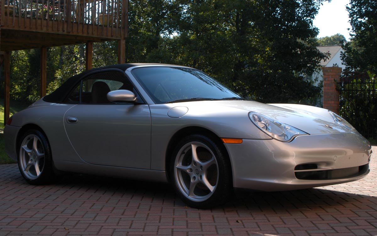

Thanks I really appreciate the comments. I had a great time doing the Z1 install. As requested, here is a picture of the whole car. After this picture was taken I changed the side marker lights (orange in the picture) to the European style (clear lenses) but have not taken a more recent picture.

I almost bought one of those. I was on the fence between a honda civic or that exact car. It was a tough desision till I woke up. :) I think there might be drool on my keyboard. :D Sweet car!

so did you have to fabricate the trim piece that surrounds the Z1 or is that part of the factory dash? If you made that piece the color match is perfect.
Posted Jul 18, 2006 · 15:02 UTC#11
I had to fabricate the 'faceplate' (the entire trim piece that directly surrounds the Z1). After creating the trim, I sanded it and used Rust-Oleum Textured Paint for Plastic (Black) to get the color / texture to match.
Thanks for the kind words. I am really happy with the finished look.
