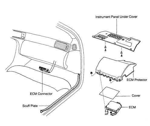

This is how I found the VSS wire on a 1999 Lexus Sc300.
You have to find the ECM. It's located under the passenger side dash. You have to peel the floor carpet back. You will see 2 screws that you can loosen.

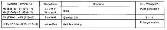

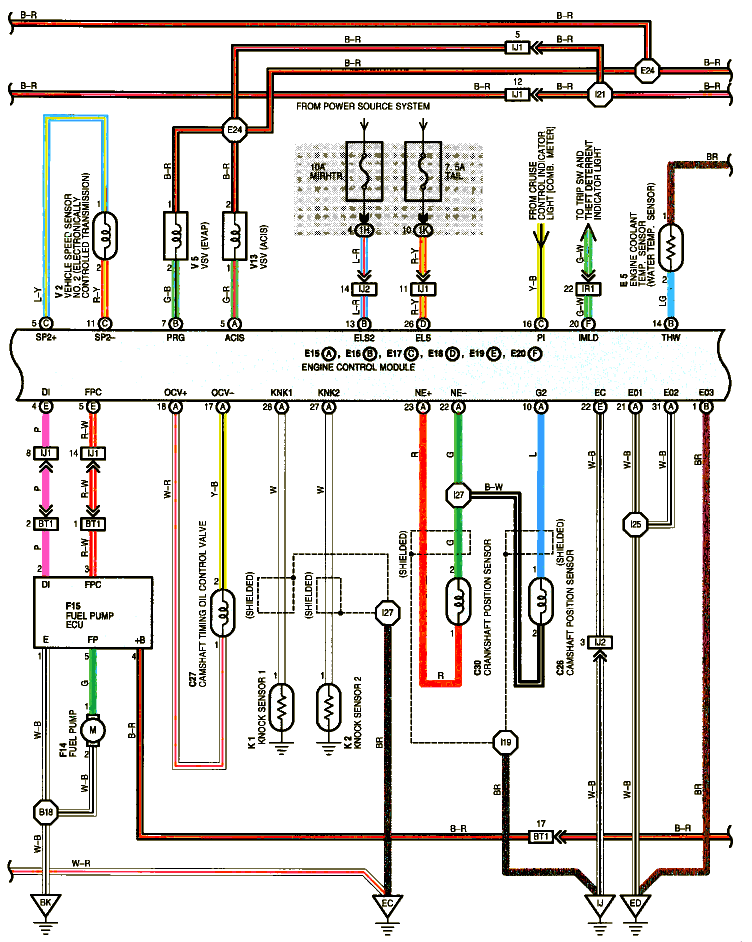

Here is the wiring diagram that I used to find the VSS wire. It's the one near the top left. Light Blue with Yellow Stripe.
Posted Nov 20, 2007 · 16:36 UTC#3

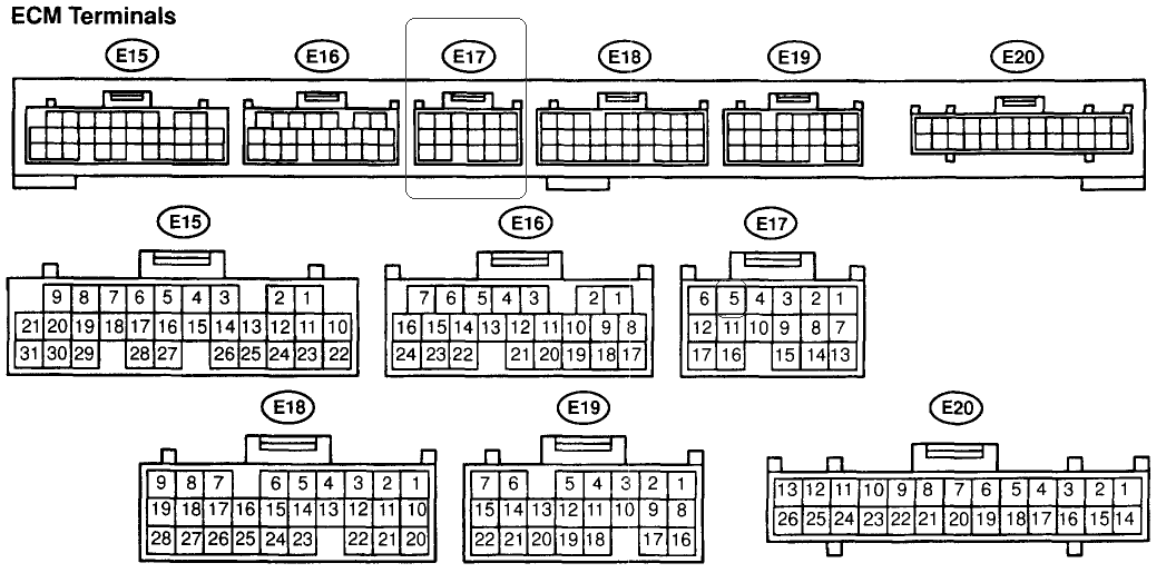

So if you look above you will see a "C". The "C" references "E17".
The 5 means the position it is in the harness. This is the wire to tap into.

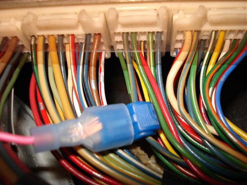

Finally this is a picture of the acutal wire you need to tap into for the VSS. I got this from ClubLexus.com.
Good Luck and I hope this helps.
