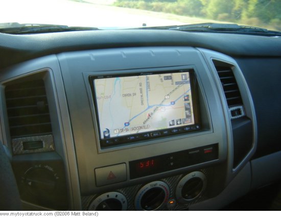

Posted Dec 16, 2007 · 22:51 UTC#6
I just helped a friend install a D3 in his 07 TRD Taco.
Get the Scosche dash kit, the color is a perfect match and the quality is very good.
The install wasn't very hard at all. I even wired up the steering controls with a PAC adapter.
Posted Dec 17, 2007 · 08:50 UTC#7
Damn, that looks nice! I didn't realize it would look so nice in this car. :)
You guys rule, appreciate it. I already ordered the z2 on amazon for about 1200-1300. Good price yeah? I don't know how to install these things so I'm going to have a friend of a friend do it for me for about 80 bucks. Just wanted to make sure its possible without having to rip the whole dashboard out. lol
