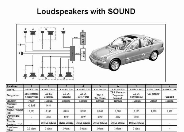

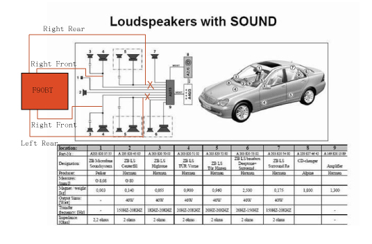

One more question, looking at the diagram, I believe that I connected my front speakers from the F90BT to 3 and 4 together (since one one set of wires connect them both) and the rears to 5, does that make it 4 ohms for each set?
Again, sorry I'm noob in these stuff, so please dont flame me if its a stupid question.

My first guess would be the draw from the amp is causing a large enough voltage drop that the head unit reboots... How big is your sub amp?I dont think I have a sub amp, all I did was bypassing the stock amp and run the speaker wires straight from the new HU- some members on a MB forum suggested me to install my HU this way so I dont have to worry about the fiber optic system on my car... Would this be a possible cause?

I have a '05 Mercedes-Benz C-class with stock H/K speakers.
