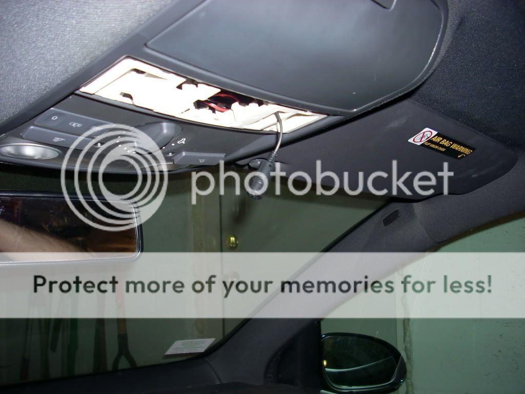

The mic wire was run up the passenger side A-pillar and across the headliner into place. There's plenty of length in the wire so it wasn't a huge deal.

Bluetooth mic installed in factory location (sounds great):
