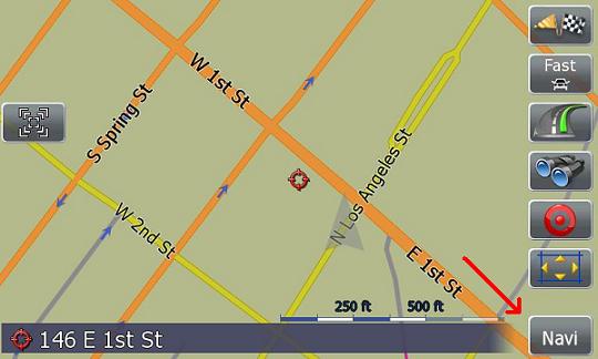

Attached is an rar file containing 30 pics of this mod and several explanations of what many of the buttons do, so that those unfamiliar with this can learn easily. Most of the pics are from the emulator but their are a few from my AVIC F7010BT. I hope many enjoy this.
[/b]I have added this to my dev build but forgot to add it to this release before packaging. If you want a navi button use this code and it will add it directly below the map scale button:Add this to the browsemap_800_480.ui file in the planmodecontrols2D section:
Thanks for the info on the NAVI button coding. I put my NAVI button in the same position as the Stan/Adnr2000 mod (see new pic). I did not change the Street indicator that goes across the bottom of the screen but since the button is semi transparent it does not matter. I also put the code at the bottom of the section the same as in the Stan/Andr2000 mod. Thanks again and thanks to Stanislavovich and Andr2000 for their work too.
Here is the code I used in case someone else wants to do this:
; Navi button on the bottom right of the screen
While looking at the code I noticed that there are zoom in (plus button) and zoom out (minus button) controls that are commented out. I would love to put these on the screen but did not yet because I would want buttons that match all the others. I don't know how to use PhotoShop enough to make ones myself yet (I need to learn). If I do get matching buttons I would move the existing zoom control button download and have those two buttons above it.
I updated the post on page one. To answer your question, add the playsound stuff after the
Hope it's clearer to you now.
