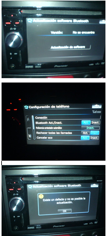

i have avic 900bt EU and unexpectedly my bluetooth died some days ago. since bluetooth does not work anymore in the window version BT noted "Version: Not Found". I tried to reset the unit, I've upgraded firmware 2.009000 (last free upgrade from the pioneer web site)...but my bluetooth still does not work.
I entered with testmode into mi unit and searched for some BT files, but i do not know which file is corrupt and i have to update.
Reading your post.. i have to erase "the contents of the folder MyFlashDisk/User / userdata / iGO / Save and User / userdata / Setup and bluetooth ... is this correct? how many files i need to delete? u remember? I need to delete the last folder "Setup" or just the files in it?

Hi, i have the same problem, mi bluetooth died some days before. Mi bt conection is not blue any more. I tried to pair it from the cell phone, also reset the unit, and nothing...
Please help me.

i have the same problem. my bluetoorh died some days ago. have european avic 900bt, firmware 2.09.
but my problem is a bit more dificult, ...i can not upgrade (install the bluetooth pineer oficial upgrade 2.9), because when i tried to upload the unzipped files to my avic...i get error message. I can not even see the bluetooth version on avic's screen!! It's so strange...Please help me. Any ideas?
