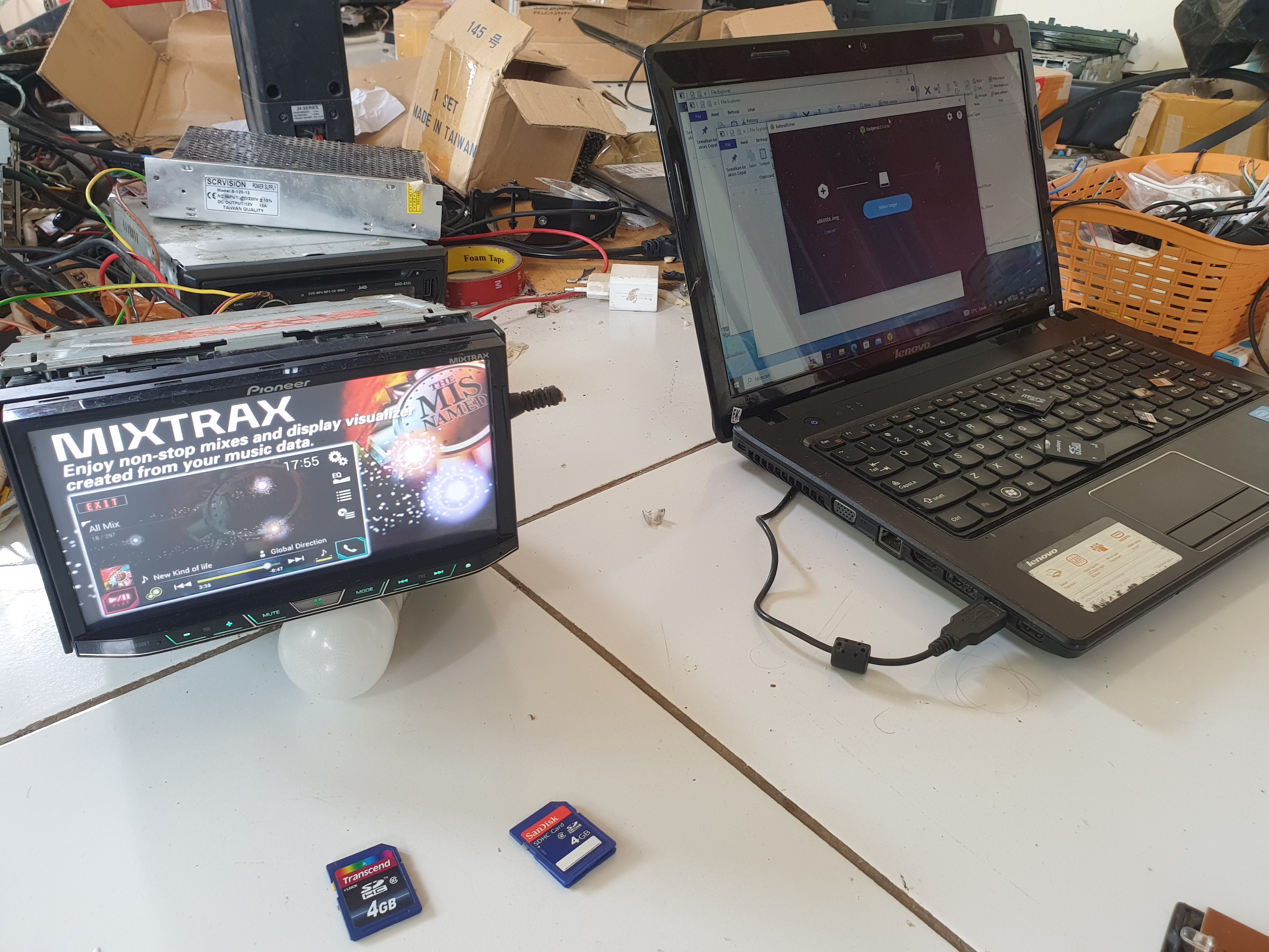

kiemchacsu Posted November 21, 2024 Report Share Posted November 21, 2024 On 10/30/2024 at 10:02 AM, kiemchacsu said: up vote this thread again I've been loopking for AVH-X8650BT software to replace the internal SD card with no hope. Anyone have it can post here? Thanks I found the Operating and manage to flash to fix the 8650 firmware error; below is the link: https://drive.google.com/drive/folders/17eDLHZ37SJ7rvW7x_2t88lNZm4vQoXC1?usp=sharing - using balenaEtcher provided to flash to a 4GB SD card. Quote Link to post Share on other sites
rano Posted March 9 Report Share Posted March 9 On 11/21/2024 at 4:14 PM, kiemchacsu said: I found the Operating and manage to flash to fix the 8650 firmware error; below is the link: https://drive.google.com/drive/folders/17eDLHZ37SJ7rvW7x_2t88lNZm4vQoXC1?usp=sharing - using balenaEtcher provided to flash to a 4GB SD card. Hello, can you contact me at WA +6281322187943 I really need your help, thank you Quote Link to post Share on other sites
rano Posted March 12 Report Share Posted March 12 terimakasi kepada tuan kiemchacsu sudah memberikan akses link software avh x8650. head unit saya kembali menyala Quote Link to post Share on other sites
