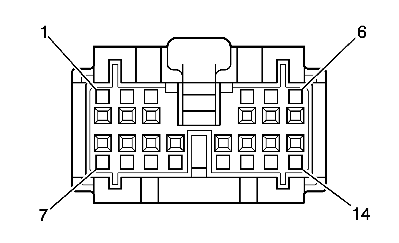

Here is what you are looking for:
pin: 4
wire color: white
Headlamp Switch Headlamps On Signal
This is located on the headlight switch. Here is the plug
