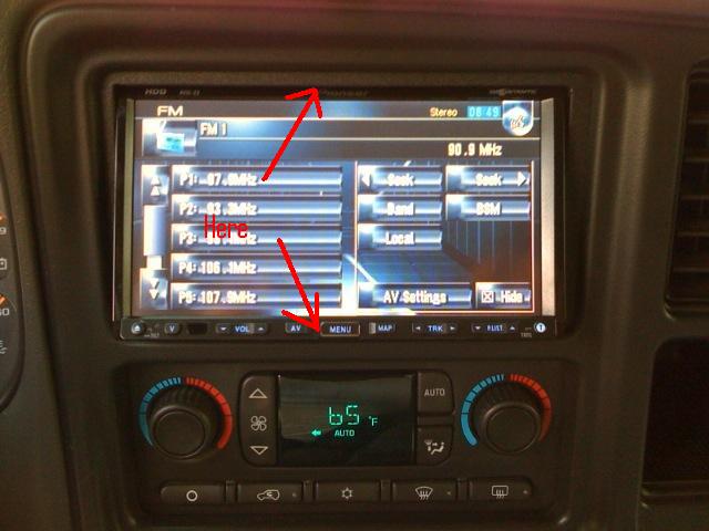

yep I just did it the 2 wire bypass does work withe the Z3..same as Z1 and Z2...also the Chevy sliverado kit has to be trimed on the inside at the top and bottom in order for the face to slide in and out
Posted Apr 05, 2008 · 04:49 UTC#27
trim here on the inside lip of the kit trim ...use a razor knife
