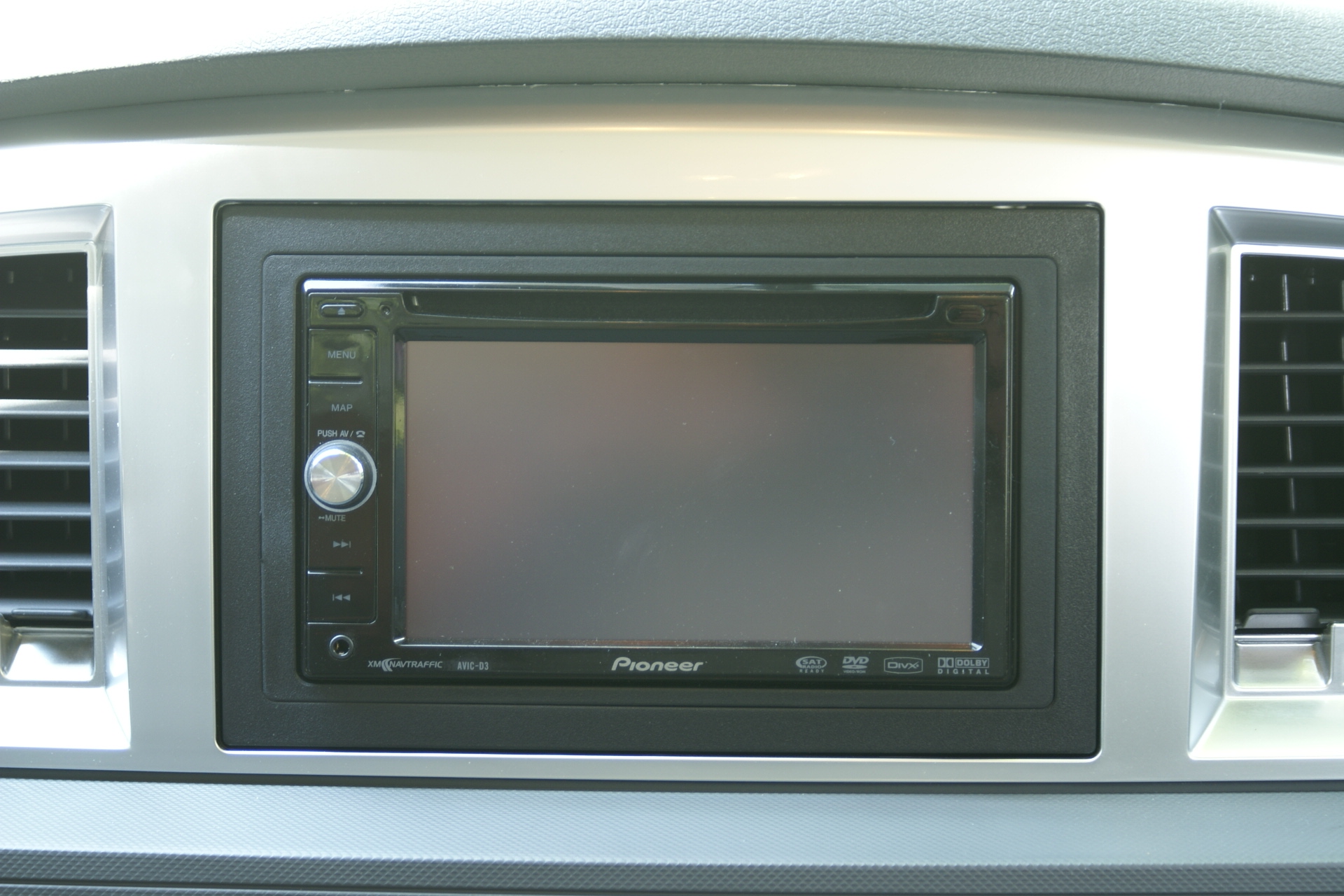

Here is a pic of the D3 in my new 08 Mega Cab with the Metra Kit
Hope this helps 8)
Sorry about the bad lighting in the pics.
