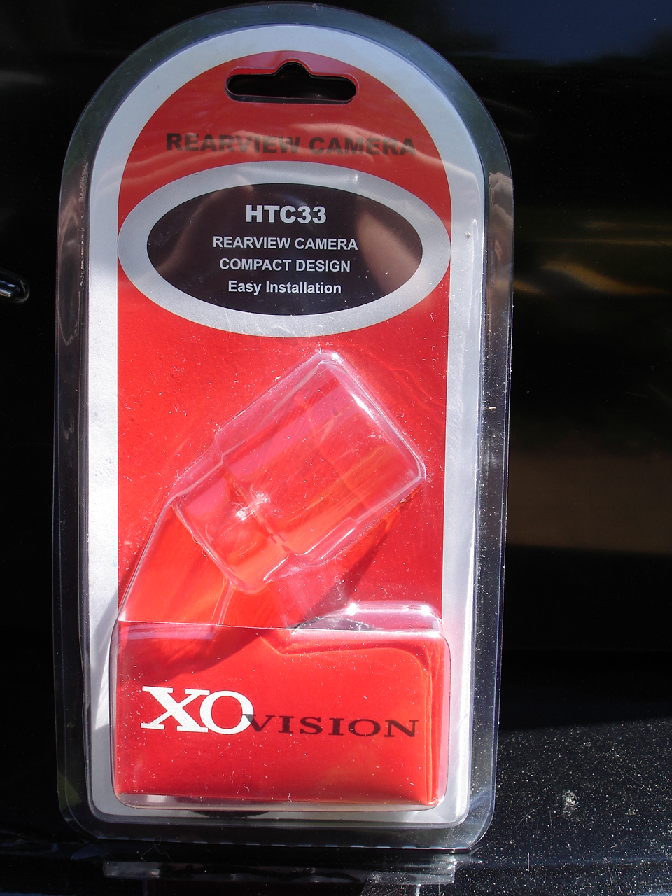

Ford F-150, installed in tailgate keyhole.

bridge4d, NICE MOUNT!
Where u get the keyhold camera... was it easy to remove your existing keyload and mount the camera in there?
Wondering what it would look like on my Mustang
Posted Apr 28, 2008 · 02:44 UTC#13
I got the camera at Fry's, http://shop4.outpost.com/product/5340908. The mount was real easy, the camera came with it's own drill bit. I popped the tailgate handle open, removed the key lock, used the supplied drill bit to open up the hole and then just screwed in the camera. Took about 10 minutes.
