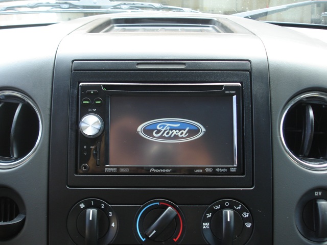

Just providing some finished product pictures for other 2004+ F150 owners that may be perusing this forum.
All operations function as expected.
All components are in the dash - plenty of room. GPS antenna under the top dash tray (plastic). Sirius antenna already on roof from prior aftermarket system, just plugged into the SC-C1 box.
Had to extended the rear sensing line to reach taillight for back-up camera.
AVIC-F900BT (Crutchfield.com)
GEX-P10HD - HD Tuner w/ Metra Y Antenna splitter
CD-SB10 & SC-C1 - Sirius Radio
CD-IU230V - iPod A/V Cable for iPod Touch
CD-RB10 - Aux-in Adapter
Boyo Back-up Camera
Amplified MTX Thunderform - Single 12"
Polk Audio db571 x 4
AT&T Samsung Blackjack

Very clean install. Nice!

Very OEM ! Which is how i prefer...
is the deck functioning as designed or casuing the flaws that i read up on?

I too was pleased with the OEM-like finish. I was prepared to fight with the dash kit to get the most flush like appearance, but it worked out.
It has the usual "flaws" that are reported here.

great install!
quick question though...how does that glossy finish look in person?
would you prefer a matte finish to go along with your dash?

Looks clean... I have the Z2 in mine F150 I think it looks more factory though.. the chrome wheel stands out. I have a f90bt that I bought installed and now it sits on the shelf because I had to many problems. I put the Z back in and I think I will stick with that for awhile.. but it sure looks good on your truck...

looks good but that Big A$$ chrome Button REally Stand out!

yup I agree when I put mine in that was the first thing I noticed... so keeping my Z2 in looks cleaner and more stock.

I wouldn't mind a matte finish but the glossy finish doesn't bother me. Same goes for the chrome multi-function knob.
Because of the shiny chrome bezels around the a/c vents I think they both blend ok with the dash.
Most friends that have seen it in person haven't said anything about the gloss finish, but they may not want to hurt my feelings :?

Looks good, although I would say aesthetically, a symmetrical HU like the Z-series would have matched the symmetrical dash design a bit better.

I Have on 08 GT with an F700BT. I no you can add new splash screens i was just wondering where you got the logo and how you installed it?

An 08 Mustang G.T. that is.

I saved some of the pics from the galley to my removable drive but when I open them on my avic -90 bt they are really small. Any suggestions?

you probably saved the 500x240 size pictures, the f series is 800x480. the picture i posted is the correct size
