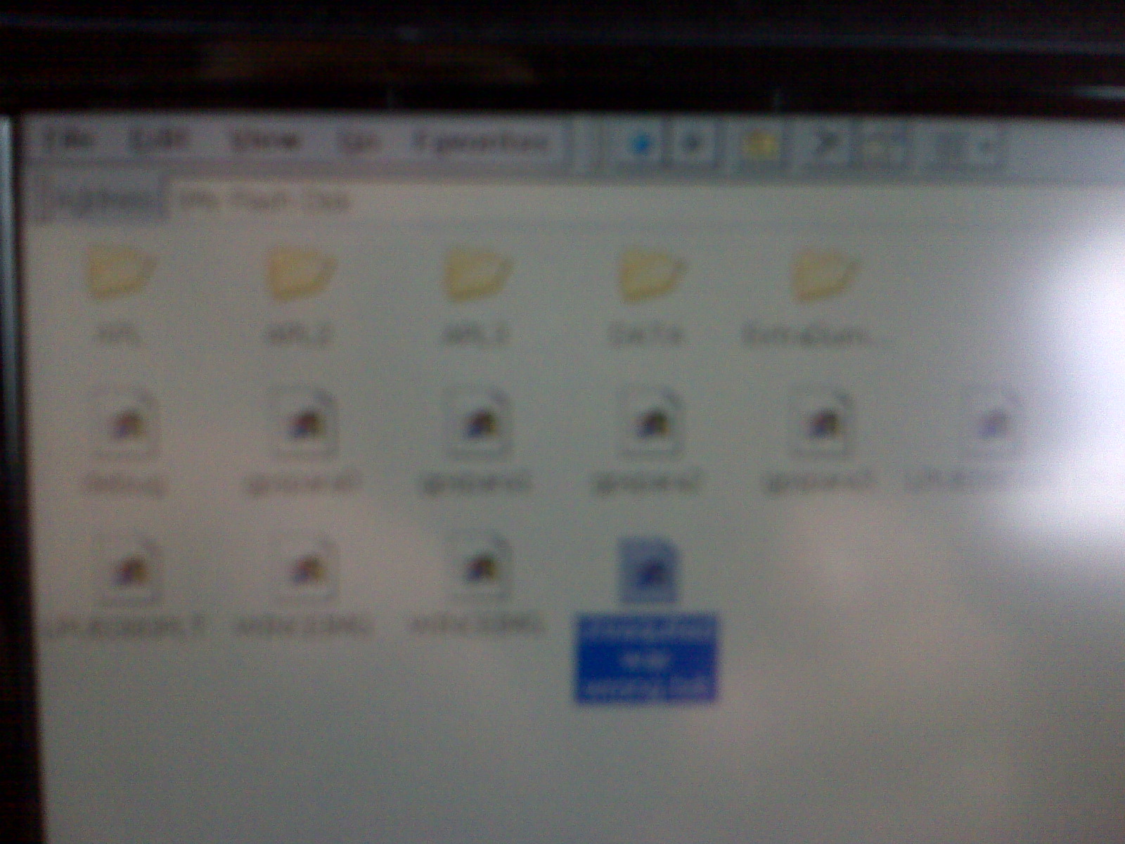

Well it looks like crap - I should have used my DSLR instead of blackberry to get the picture. But I created a text file and copied it to the SD card, then copied THAT to the "My Flash Drive". I also created a new folder in "My Flash Drive" then deleted it.
So its not locked.

I think Pioneer accidentally allowed us into the 'guts' of the unit with their initial firmware update. That one had the 'Testmode' and 'MiTACAP' folders which are the only way I know of to boot into WinCE. Notice that the updated firmware release (the one currently at the Pioneer website) does NOT include these files... :shock:
I decided to play around with the WinCE interface tonight. I didn't make any changes yet, but I thought you guys might want to see some of the info in the WinCE Control Panel. I stuck a bunch of pictures HERE.
Also, I transferred the entire contents of the flash disk to my computer (via SD card). I've attached an Excel spreadsheet (in the zip file) listing the folders and files on the flash disk, if anyone is interested. A quick 'properties' shows that the flash disk has 1095 files in 55 folders, and these files take up 1.64Gb of space.
Now, where to start hacking?... :wink:
-Eric
FlashDiskContents.zip
