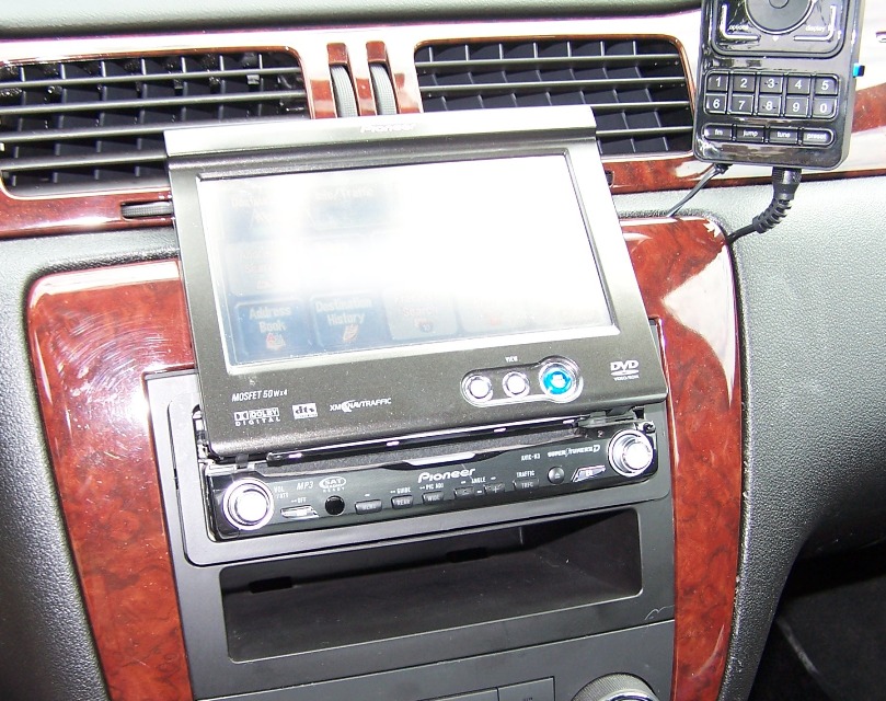

I finally got my N3 working in my Impala. I've attached some pictures to show how it looks and where I grounded my cables for the bypass. I purchased the GMOS-LAN-01 Scosche device so I wouldn't need to tap into the VSS or reverse signal wire.

I see you got 1 ground to the avic, 1 to the blue thing, what's the other ground for?
Posted Aug 04, 2008 · 11:08 UTC#6
There is one ground wire running from the AVIC harness (the blue thing)
There is one ground wire running from the parking brake sensor (light green wire connected to black ground wire, this is for the bypass)
There is one ground wire running from the Scoche GMOS-LAN-01 harness

I love how there is so much room behind that dash.

Everything was working fine for a while, now my battery is draining pretty much overnight!
I did some troubleshooting and from the looks of it if I disconnect everything from the vehicle the car starts the next morning; if I disconnect JUST the N3, the battery still drains. That makes me believe it could be the Scosche GMOS-LAN-01 that is the culprit?
Using my pictures included, does anyone see anything glaring from a wiring perspective? I bought this unit used and when I first hooked it up, the previous owner had connected the red wire to the yellow wires for some reason!
I fixed that but not sure if there's anything else wrong.
Thanks for the feedback in advance...

If it was working fine before, check your charging system, battery connections and the battery too. I had a similar event with an alarm, and it turned out to be a bad battery.

Sorry should have mentioned that; I had the battery tested under load & the results stated the battery isn't bad...
Posted Oct 14, 2008 · 19:53 UTC#16
Update:
I put my factory radio back in and haven't had any battery problems so I'm going to err on the side of the issue being the GMOS-LAN-01 rather than a bad battery...
