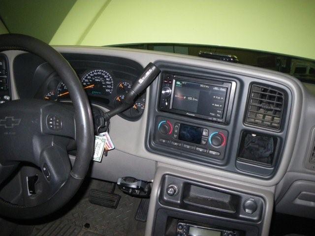

Has anyone installed one in these vehicles as of yet?
I just changed to a F700BT from a Z1 (been working on it most of the day today). Got it installed but I don't really like the way its sitting in the dash right now. One setting is either to far in or slightly too far out (the way it is seen now). Its flexing the plastic ring a little cause its out too far.
If anyone has done it, what mounting kit did you go with? My Z1 seemed to fit a little better in the dash than the F700. I am using a metra multi kit (few years old as it was used on my Z1 install). Can anyone recommend a better part # or link.
It is installed and running with the bypass. Going to go for a test drive once I get everything cleaned up.
So far everything seems to be working! :D
Posted Aug 17, 2008 · 01:29 UTC#2
Just thought I would report for anyone interested. Went for a 30 min drive. Bypass is working. Back up camera is working. Bluetooth is working great. So far the voice recognition worked every time for making calls. I was able to download my phonebook (LG VX-8600) no problem. My steering wheel controls are also working. Mute, volume source, truck-up etc. So far I am a satisfied F-Series customer!
Now other than I different dash kit (if thats even avaliable) I just need to figure out what format divx files it likes best and get my dam IPOD cable. (didn't get here yet)

I like using the American International kit for the trucks. But, can't you just drill some new holes on your current kit to get it positioned the way you want it?

I've got an F90 in an 04 Silverado SS and I think I'm using the American Int'l kit. I just rode out to Best Buy and picked it up for 15 bucks. Seems to sit about right in the truck.

Thanks for the reply. I was just on the American Intl website. Their kit appears to have long slotted holes so any depth can be set. Looks like I'm gonna have to make a best buy run today.
About the steering wheel control wire. I installed that back in 2006 when I first installed my Z1. My memory is fading!
Check out this thread http://avic411.com/forum/viewtopic.php?t=3398&highlight=classic
It describes just about everything for installing in a Silverado including the steering wheel interface. Good Luck!
Posted Aug 18, 2008 · 17:05 UTC#6
Cool! Thanks for the link.
Posted Aug 19, 2008 · 20:19 UTC#7
Went and got the new install kit from best buy. It's way better than the one I had before. This forum is great! I didn't to take get any pics yet but its a lot cleaner. I also picked up a IPOD cable. Ipod 5G 30GB Video is now up and running! :D
