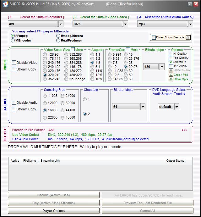

I am an idiot, its SUPER
not simple
haha
Here is what I use
Posted Feb 10, 2009 · 03:19 UTC#11
PS when you click encode be sure to select the top divx option which is like all divx or something
Posted Feb 10, 2009 · 19:21 UTC#12
wow thank you sooo much for that im gonna try it right now!

Posted Feb 11, 2009 · 18:32 UTC#13
ok well I did exactly what you told me but the video is very small on the screen. it does run smoothly but the movie size is very small so it should. Im gonna play around with the settings to see if i can get it full screen but still have no chopping and good sound.

There should really be a sticky about video formats in this forum. See my post in this thread for the settings I have used successfully.
http://www.avic411.com/forum/viewtopic.php?t=21389
For play back from SD or USB there is no point to using a frame rate higher than 24.0, a bit rate greater than 480, and an audio sample rate higher than 44100. The unit (as per the manual) cannot use it.
For the codec: MPEG4>H264>xvid.
If you use the exact settings I mention in the link within your program of choice, I think you will find it tolerable for playback. Don't expect an extremely speedy interface though unless you use an ipod/iphone for playback.
