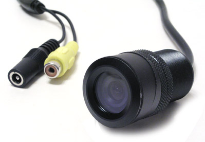

Okay, I just purchased the camera in my previous post, then remembered to check the method of wiring this thing up to the Z1.... THe video cable is self-explanatory, but how about the following pic ...
Do I have this correct? The yellow video cable will plug directly into the RCA plug at the back of the Z1. Then, what do we do to make this power part work??? See the Ebay camera pic...
Thanks again.

Posted Jan 16, 2007 · 22:53 UTC#20
I'm guessing that the cable attached to the camera is around 1' long (mine was). Which means you should have a second cable that is something like 18' long. One end has the reverse of what you see (so it can plug into the camera). The other end should have an RCA jack (for the video) and two wires to connect to a 12V power source (might want to use the amp wire) and ground. Unfortunately, it doesn't appear to say in the description.
If it doesn't have a wire, you should be able to get a connector from an electronic store like Radio Shack. Just make sure that the connector fits snugly. Also, check your documentation to find out where the +ve and -ve poles are.
If you can't get a connector, then your final option, I think, would be to snip the connector off, and hope that the wire underneath is color-coded (correctly). Forget about returning it if it's defective, tho'. Definitely the worst of the three options.
