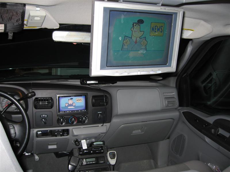

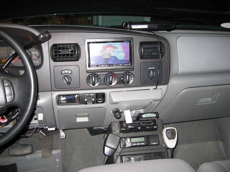

I didn't take a pic of the switch, it's just a toggle switch on the left of the steering wheel on the lower dash. Here is the Z1 with the rear screen and all his radios and his light (he is a local cop and fire chief).
