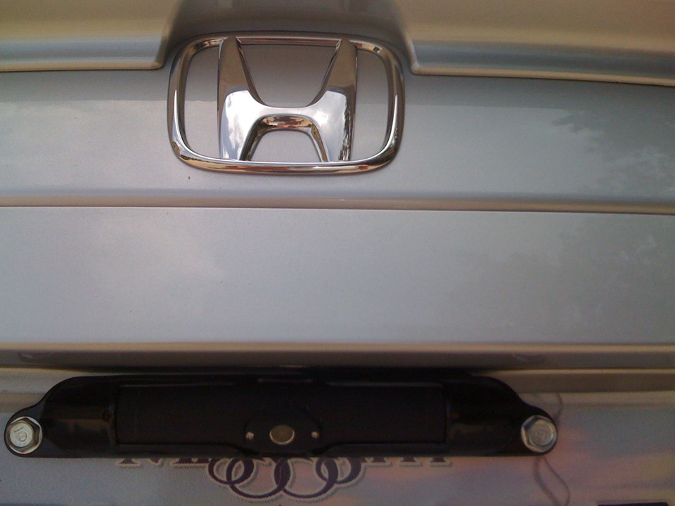

I also added an Audiovox Rear Camera license plate frame. Retail is $100, I got it from ebay as a Refurb, (poorly repackaged, I guess a customer return). It was $50, and I made offer of $42 and got it.
I have everything hooded up and it works well, the only thing remaining is to correctly route the video cable through the trunk to the trunk lid. I do not think I will be able to route it through the factory weatherproof cable housing.

I would say not. I chose mine based on mount. I searched dozens of different ones based soley on external appearance. I would bet that they all have about the same video quality, and I wasn't too concerned about that. The audiovox one is all metal with metal license plate frame. It does not have illumination leds, but since it is mainly used for bumper-bumper, the backup lights work great. It also has a microphone which I am not using.
I might remove it again and paint it to match the car. I think it would work well, and might look even a bit better.I did have to drill a fairly large (11/16") hole for the wires, but it came with a nice grommet, and it is behind the license plate and on my car the trunk had a recessed panel there anyway, kinda hard to explain, but works well. It is asustable with 3 different angles downward, and the default middle setting leaves just a hair of the rear bumper in view, almost perfect. When I backup until the ground is no longer visible between the bumpers, I am about 2½" away!
