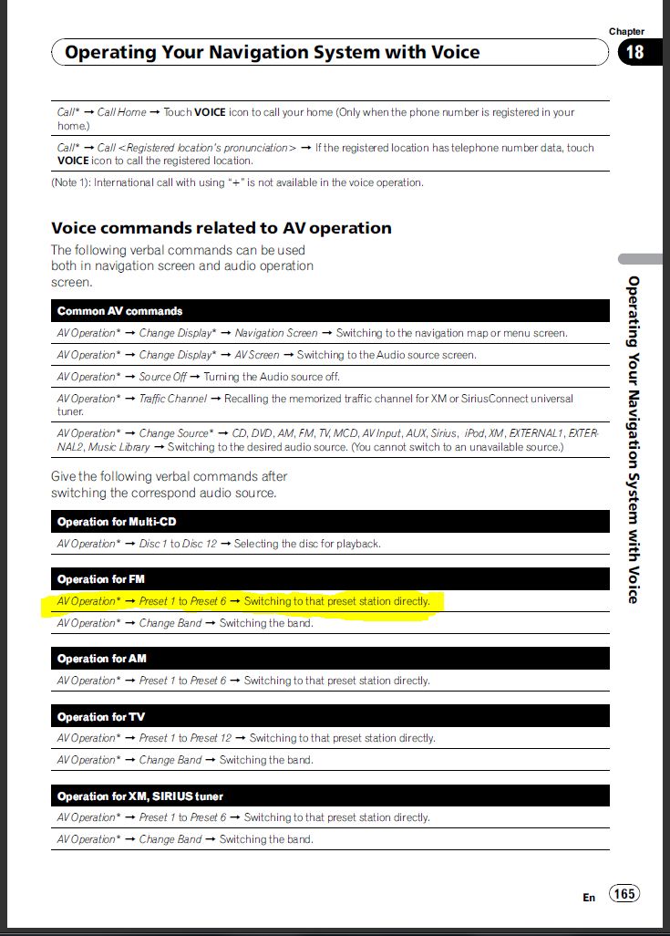

Posted Dec 11, 2009 · 23:41 UTC#16
No, you can't change tracks, presets, or seek with the VR.
Posted Dec 11, 2009 · 23:55 UTC#17
Well that's a suck.... Seems like such a basic function.... Oh Well...
From the Z3 manual....
Posted Dec 13, 2009 · 03:07 UTC#18
WOW!!!
I was hoping that I got some kind of feedback from my last post...as in..."hey..even though the manual doesn't mention it, all those commands work!!!" or that it carried over all the commands from the previous Z series.... like these that I've uploaded to my server...(which is only the short list believe it or not)
http://www.dawgbonez.com/Misc/Available ... mmands.doc
I think I may be reconsidering this unit... Seems almost like a downgrade to me.... Especially being that I have a SWIX that works 100% and not 95% or less....
In other words, the +'s are not seeming to be much more(if any) than the -'s at this point.... ugghhhh
Posted Dec 13, 2009 · 04:29 UTC#19
All of those commands are present in the Z110BT except preset select and the traffic channel select and maybe source off. Other then that, the Z110BT completely upgrades nearly every feature of the previous Z series. Maybe you should just ask the previous Z owners that now have the 110 what they think.
