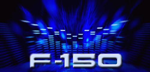

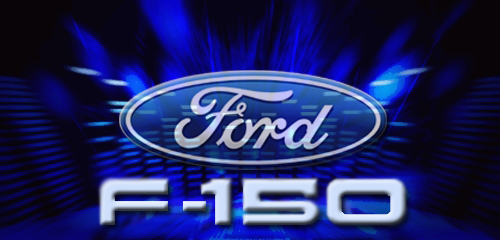

Any chance someone can put together an F-150 background? I'm not 100% sure how to edit these pims but I love that custom Mustang one on the equalizer background.
Posted May 15, 2006 · 23:04 UTC#27
Since you like the Mustang one I made, I tried to keep it as close as possible.
Let me know if you want something else.
Posted May 15, 2006 · 23:17 UTC#28
VERY NICE! Much thanks! Could I bother you to make an adjustment? Same pic but without the Ford oval. I would like to see how both look onscreen.
Thanks again!
Posted May 15, 2006 · 23:21 UTC#29
Here ya go. Thank god for Photoshop Layers. :wink:
Posted May 15, 2006 · 23:23 UTC#30
You the man!

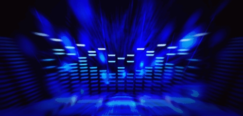

Can you please post that parametric EQ blue background image alone? I want to Photoshop my FJ into it for my startup screen.
Can I have multiple .PIM files with the single background JPG on the same DVD? Does it browse the .PIM files from DVD or does it load them into RAM as well? How many can you have?
Thanks a million for this. I was REALLY hoping this would work on the D1... I already did XM Nav/Traffic and backup cam. Great unit.
Adam
Posted May 19, 2006 · 22:09 UTC#33
Here ya go! You can have up to 10 pims in the folder I think.
Posted May 19, 2006 · 22:13 UTC#34
Man you're fast!
Thanks a million.
Only question.. to do the PIM files do you have to burn a Nav DVD and replace the files in the correct folder or can you have a PIM only DVD?

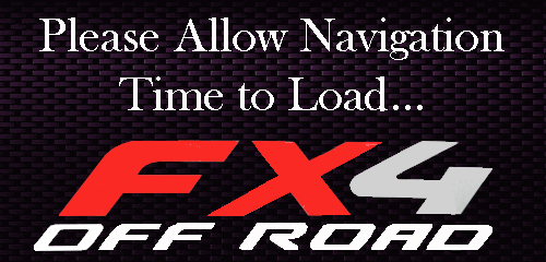

When changing .PIM's for XM icons, does the burnt disc have to stay in the drive or, like with bootscreens & backgrounds, can the disc be removed once the icon has been opened? I'm guessing that the disc will have to stay in BUT I haven't tried it yet. I just didn't want to burn a DL disc if I didn't need to.
Attached is my 1st (successful) attempt at a custom bootscreen. Thanks for all the help in getting the information to play with that!
