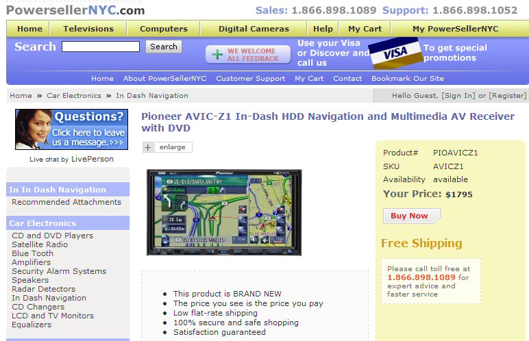

According to Pricegrabber, a place called PowerSellerNYC.com has it for the best price. See the attached JPG.
Also shows it's in stock with free shipping. I don't know if it's true or if they are a reliable reseller...or is this more $ than those who know the system would pay for it?
