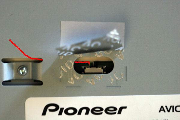

There is a switch behind your warantee sticker on the back of your unit. You have to be careful as to not void your warantee. It does not require any soldering or anything. It was added to create a greater convince to those who are installing them in RV's and boats.
You still have to ground the parking brake wire(green) to the chasis. I would suggest grounding it at the same spot you ground the whole unit(black wire)

ya, posting that you have the info, and will offer it for money is lame....i dont have the d3 nor have I seen the bottom of it, but does the hole in the case exist where you could slide a paperclip or syringe and reach the swich to flip it? saw that method in another forum for, i think, the n3. don't even have to touch the sticker, you just slide a syringe in a vent hole in the case carefully and click the switch over.
Posted Mar 03, 2007 · 08:43 UTC#10
ya, its the n3 that method is used for (read previous post) heres a pic of the hole....maybe if you d3 owners are lucky enough that hole is in the vicinity so you can surgically switch it on and off

pj818mbr, there is absolutely no hole in the vicinity around the sticker.
I'm going outside right now to heat this hole up and try to flip the switch! Haven't gotten my car back together yet from yesterday, found out after taking it apart that crutchfield recommended the wrong harness for my car. So I'm waiting for it to come in today, I got saturday delivery. Hope it comes in soon!

Hmm... just lifted that sticker... didn't see any switch! Further elaborations or pictures would be appreciated!
Posted Mar 03, 2007 · 15:01 UTC#17
Wrong sticker?
Posted Mar 03, 2007 · 16:13 UTC#18
I lifted the big white sticker that has the pioneer logo and says AVIC D3, the serial number and a lot of small print.
There are 2 holes under there, one near the middle of the sticker, but go up and right a tad (this is exposed to the inside of the unit, but i didn't see a switch. Just a couple of resistors I believe), then there is one near the bottom of the sticker in the center (bottom of a screw under there).
Can't feel any holes under any of the other stickers (there are 2 smaller stickers on the top of the unit) so I'm pretty sure I did the right sticker.
