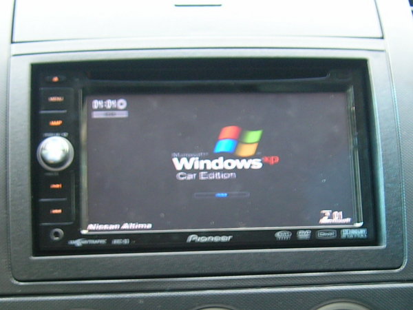

Hooked up vss wire and the reverse wire. Also hooked up the Pac-swi for steering wheel control. Everything went smooth. Installed the back up cam on the car seat so I can watch my baby without turning around. It's installed with velcro so its removeable

I like the second one better
Posted Mar 24, 2007 · 21:24 UTC#10
me 2. I have it set as "Splash Screen"
