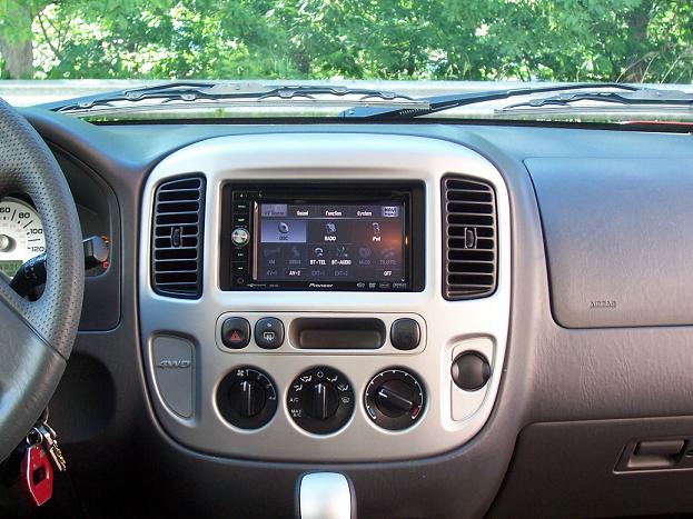

Hey everyone.....Just wanted everyone's opinion on the install that Circuit City here in Pittsburgh (North Hills) did for me. They installed the D3 with the IPOD adapter and the Bluetooh in a 2007 Ford Escape.

Straight forward install. did they actually hook up the vss and illumination wires?

Actually....Im not sure about the VSS; however, the navigation is extremely accurate so I am GUESSING that they did. Is there some way I can look in the settings and check to be sure? They did not do the illumination wire on the first try, but after I printed off a page from this forum about it and showed it to them, they did it free of charge and it works great!
Posted Jun 10, 2007 · 01:57 UTC#5
Hit the 3D Calibration button under Hardware Settings...if the speedpulse goes up while driving, but stops when idle, it was hooked up right :)

Speed pulse stays at ZERO. I only drove up the road and back so I wasn't going very fast but am guessing that shouldn't make a difference. So now what???? LOL

tell them they did not install it properly. They must do this for free since the VSS wire should be part of the install. The VSS wire is part of the navigation system. It isnt needed to work, but it wouldnt be there if Pioneer didnt want it installed ;)

Take it back to them. Ask them to hook it up, try not to be rude about it. Beleive me being rude about something like that is a good way to get blown off. If they claim not to be able to, they have access to the same info I do.
Speed Sense gray/black ac ABS or brake system control module
Notes: The ABS control module is on the rear driver side of the engine compartment. On the Hybrid models, the brake system control module is on the rear passenger side of the engine compartment.
On vehicles with the 6-disc in-dash CD changer, this wire is also found in the radio harness.
