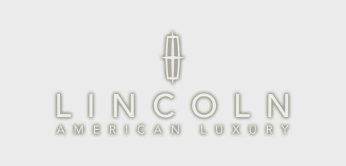

Personally I want to change my boot up screen to this:

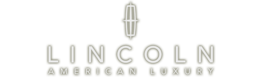

Maybe something like one of these (the above PNG has transparent layers behind it so you would need to fill your background with something).

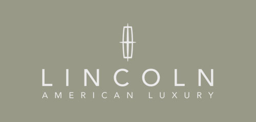

Or this...
I'm unstoppable!
PS. pm me if you want the full sized BMP files, these are small jpg files.

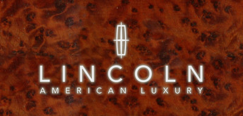

If anyone finds a PNG file from that link they would like into a background or a boot screen (if you get that far with the hdd hacking) I would be more than welcome to merge them. I did a google image search for the background for this example "burl wood" and found this in one of the links. I'm not good at making pictures from scratch, but I can merge pics that are already created.
By the way, this is my current background and as soon as I get time to rip out the hard drive, I plan on making this my boot screen.

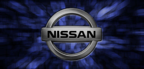

I made this one for myself. Feel free to use it if anyone else has a Nissan. I think I'll make a Z one too. I like the Z logo better than the Hamburger.
I've included a zipped bmp (the native format) so you can have the full file along with a jpeg so you can see what it looks like.
